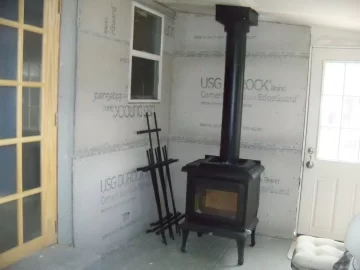

Well I finally got my Roby installed and it has two cooking plates and a top plate made of cast iron that is very heavy but makes the top of the stove shiny and has room for bacon and hotcakes I think I could use it for that...not sure yet..It also has some kind of brick inside that moves around and I do not know what that is and if they are good or not for heating...Need to check further on this...The stack I had him put as a straight pipe because it would be easier to clean and the air flow I think would be better. The stove door is hard to open but the installer showed me how and said it was because of new gaskets and the first burning when I do it ---the stove will smell--I think burning off stuff so that it is "seasoned"--my words here ---I think this would be "why" the smell to it--I will open up the windows if it gets too bad...Its just sitting there right now brand new and shiny in a brand new built room that I enclosed from a open porch...The stove is sitting on a cement floor and that has insulation under it that was recommended from a poster on this forum...Pictures pretty soon when I get time...clancey
That's what the installer said but I didn't know exactly where it came from...thanks...Those stove pipes are larger than I thought they would be picture here and I wonder how large those baby bear stove pipes would be and I hope that old bholler answers this question because he seems not to like the bear family of stoves...lol...How large are those pipes? Another picture coming of my beautiful new stove just sitting there looking pretty but it gives me a real peace of mind knowing that I have it if I need it...There is a metal silver movable piece that slides back and forth and what might this be forgot to ask the stove man..? clancey

Baby bears use 6" pipe. It isn't that I don't like fishers they are perfectly good stoves for their day. It is just that their day was a long time ago.
All stoves come with firebrick now...it helps protect the metal stove floor/walls from the fire (lasts longer) and can help make the fire burn hotter (cleaner) too...
Reactions: bholler
Ha Ha Ha ---Just like me for my days were a long time ago...enjoyed--thanks---But I still love that Bear Family of Stoves and their advertisement was just excellent--in their day....You are telling me that my piping I think is 8 inch is larger than those large stoves? ,,or is mine 6 inches too.? Is that firebrick expensive to buy and does it ever go bad brenndatomu or crack maybe Thanks everyone clancey..
Yours should be 6" as well. And the baby bear was a tiny stove not large at all. I am sure it would have worked on a 5"
Yes brick are wear items which will periodically need replacement.
Reactions: Shrewboy
I'm sure your pipe is 6"...it goes by the inside diameter, not the outside...if you have doublewall pipe it will certainly be bigger than 6" outside.
The bricks can crack if you load wood harshly (throw it in) but the bricks are not generally expensive to replace.
Most all. Some use cast-iron liners.
Our firebricks are now going on 12 yrs old and still serving. There are a couple of cracks due to me putting wood in too assertively, but they are holding in place still. I may swap them for floor bricks this summer.
Oh, and even if the bricks do crack, that does not necessarily warrant replacement, unless the pieces will not stay put...and even then, the firebrick(s) can be repaired by "gluing" it back together using furnace cement...that works well!

The connector on the stove determines the pipe and chimney size. Normally they should be the same. Baby, Mama, and Papa used 6 inch. They were the single door stoves from the Bear Series. The Fireplace series with double doors used larger 8 inch. The more efficient models with 2 doors also used 6 inch, but there were special requirements such as double wall pipe inside to keep them efficient.
Start it the first time with a small fire and open doors and windows. The pipe will smoke off as well as the stove. High temperature paints are soft until they are cured with heat and do give off some obnoxious fumes
The bricks inside reflect heat back into the firebox to raise the fire temperature, since the hotter it burns, the cleaner. They are made with water like cement, so new brick is high in moisture content. It will take a few hours to dry them out with your first fire. The steam rises out the chimney taking a lot of heat along with it. So expect the next fire to feel much more heat from the stove. The same over the summer when brick absorbs moisture from the humid summer air. The first fire may seem like the stove isn’t getting very hot.
You will find where it gets hotter on the top for cooking. The difference cooking on a wood stove is you simply move the pans around to the desired heat instead of regulating the burner temperature. To simmer, raise the pots, pans or kettle with a trivet to prevent direct contact with stove top. Practice with a tea kettle, then soups or stews. They are best for simmering a slow cooked meal all day like you would use a crock pot. Open pan cooking such as bacon tends to spatter grease everywhere making a mess, so keep anything like that covered.
Unfortunately griddles are no longer made totally flat on the bottom for good contact. They all have a lip or are made to go over stove top burners. You’ll find pots with copper bottom or aluminum heat much faster than a stainless steel pot or pan. It’s amazing how many things normally cooked in an oven can be cooked on a stove top in an emergency.
