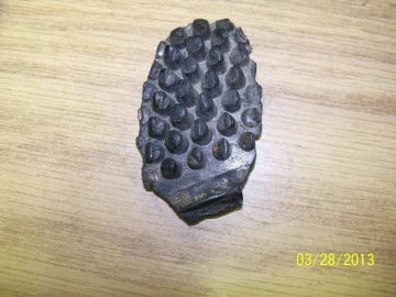

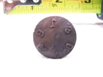

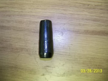

    I have no idea what they use for raw material, but the nail doesn't mean they're using pallets - they still could be but the nail wouldn't prove it. The one possibility that I know is not possible at all is for any object to make it through a pellet machine without being pelletized.
    Just as an example of the amount of pressure applied in a pellet machine, there's 2 pictures attached. Each roll running inside the die has 2 tapered roller bearings. The first picture is a hardened steel roller from a bearing that failed. The second picture is another roller from the same bearing that got out when the bearing failed. Anything that goes into a pellet machine has to be pressed between the die and the rolls, which makes for pretty cool examples, but they aren't so fun to deal with at the time.
    A nail wouldn't even slow the machine or make a noise but would be mashed into pellets. That's why there are normally several other systems in place to prevent metal from ever reaching pellet machines.
    I don't doubt at all that you had a pallet nail in the bag. It just had to be introduced into the bag in some other way than through the pre-pelletizing production stream - somewhere after the pellet machines.

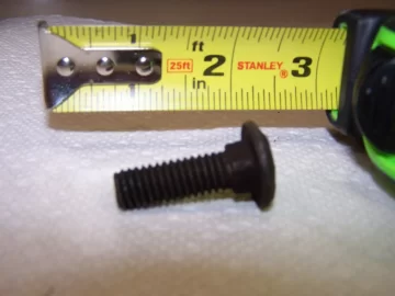

    Cleaning out my Esse Cook Stove last year , I'm running my shop vac which sits outside and a hose comes in through a window by the stove.. I'm cleaning the passages around the oven itself... So I shut the vac down and hear something in the hose as I move the hose around... Turns out to be this bolt... Was it in the hose from cleaning the garage floor or the stove? I sent a picture to Esse, nope , not their bolt... Well this year I was cleaning it out and laying flat against the inside smoke chamber was a 3/8's inch flat washer.... so now I know the bolt was in the stove too.. So I figure the workers in the factory must throw some bolts and washers through the air just to cause a disturbance for maybe someone welding on an open stove.. A little factory fun...

    You best pay attention to what ScotL is saying about it not entering the input side of a pellet press and come out as a recognizable nail, he makes multiple thousands of tons of pellets every year.
    He doesn't buy them.
    The pictures he provided from his own system shows what a pellet machine does to anything entering its feed system, after leaving the press and being bagged is where that nail got into the bag.

    And they would get pelletized and wouldn't be in the shape that Sophie had. Those dies make short work of everything that enters them.
