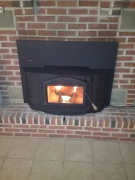

Well for those of you who had been helping/following my stove quest I finally got my Napoleon 1402 insert installed on Friday. I had purchased and installed an Englander 13NC which I wasn't happy with. I removed that and purchased the Napoleon and man what a difference! This Napoleon insert is fantastic! I have nothing but good things to say about it. The blowers are super quiet, the firebox at 18x18 is perfect for me and the stove just really looks great. I burned it all weekend here in eastern PA with mid 20 degree temps at night and 30's during the day. My home is a bilevel and it had my upstairs crusing at 75 degrees and my back bedrooms were around 73. I am getting great overnight burns out of it as well. If you are in the market for an Insert I would really consider Napoleon. Attached is a pic of my first burn with it.

Nice, it's good to hear that you are getting some good warmth and enjoying the stove. Thanks for the update.

Thanks for all your help! I really appreciate it as well as every one else who had input on this process! It's really amazing what a bigger size firebox will do. I have about 1400 sq ft and the Napoleon is handling it really well. No issues with heat output for the space i have. I am using one small fan to help pull heat from the stove room into the stairwell that leads upstairs. At a few points last night it was 25 degrees outside and my thermostat upstairs was reading 78 degrees!

Room is approximately 300-400 sq ft. I have 4 circular vents cut in the ceiling to allow the heat to rise up to my upstairs. Fan is about 20ft or so from the stove pointed directly at it running on low. The fan is sitting at an angle so the air is being pulled from the stairwell and pushed towards the stove. It is working really well. Do you have any vents in your ceiling to allow the air to move up through the floor? Are you using the blowers on your stove?
Awesome! That is great to hear. Sounds like the 1402 was a great fit for you and your set up. Looks great too. Good luck with it.
