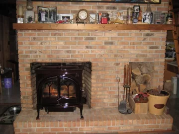

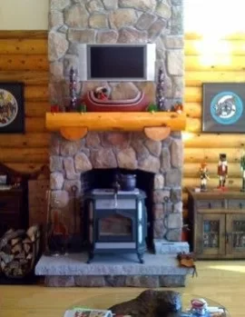

I think he has settled on getting an Insert and not a freestanding stove.
But that is another idea if he wants to build a hearth in front of his existing fireplace.

I'm definitely limited to inserts only. My existing FP opening is only 24" high. That would make for a VERY stubby stove:)
