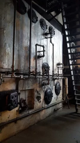

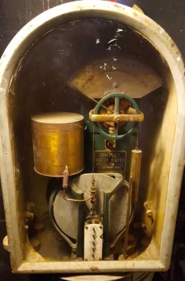

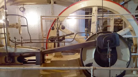

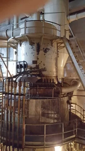

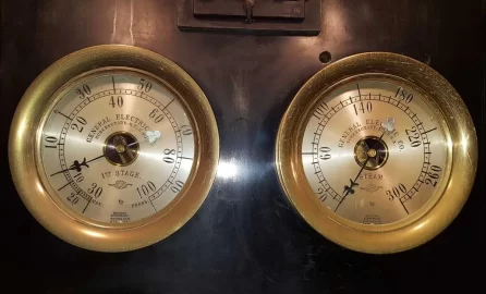

I toured the original Seattle steam electric plant last December. It was quite a different technology and far from clean. It's good to see progress. One thing in common, it also required a lot of walking to get around. I'd like to visit a modern plant.
