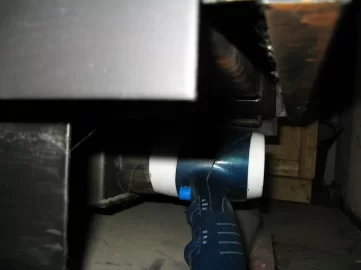

Please pay no attention to the dirt :red: It is a basement install after all.

Pen, do you light a top down or traditional type fire? Do you shut the door immediately after lighting and then put the hair drier in?
I know someone asked (too lazy to go back and quote) about where the smoke is coming out. It's coming back out of the firebox all around the door.
Thanks for the physics explanations, I was a aware of the basics, but didn't realize all of the factors working against me with regard to a basement install. I did have a radon system installed in the basement at the end of last winter that may contribute to more of the pressure inequalities as well.
With all of these factors aside, should a 45 degree replacement fix this?
the 45's will in no way hurt a thing.
However, before you go and do it I'd suggest you post a few pics of the install so we can get a better idea of what you are working with. Single wall elbows can be adjustable, so if it's not a perfect 45, that's generally OK.
I sometimes start top down, sometimes put a medium load in there and throw a 1/4 of a super ceder in the middle of that, it's all on the mood.
I've had problems doing it every way imaginable. However, if I see it developing I leave the door closed and put the hair dryer in and let it rip. If I did it prior to lighting, I could probably prevent the issue.
Also an OAK is an outside air kit. This would fit over top of the hole in the back where I have the hair dryer and would allow the stove to suck in outside air instead of air from in your home.
