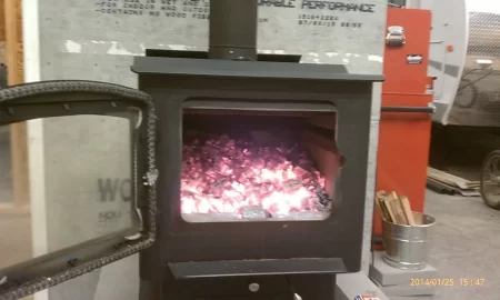

I have this stove in my shop and it was well below freezing this weekend and that means that the shop was very cold. I had some plumbing to do so I needed to warm up the shop. The NC is my weapon of choice and it did very well with a box fan blowing on it and me trying to keep temps at 600-700.

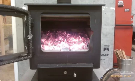

I was burning maple, nice blue flames, and I noticed that my firebox was shrinking. A deep coal bed builds up that can't be spent unless the stove goes cold. I tried the old trick of burning off a couple splits with full air and no luck, I needed heat.
Open door fireviewing with that bed of coals is sure a warm experience.
A nice benefit is that this big old pile of coals was still sufficient 12 hours later when I restarted the fire the next day.

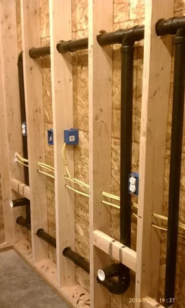

That's some interesting plumbing. What's the appliance?
Wort chiller and sink?

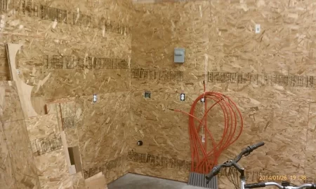

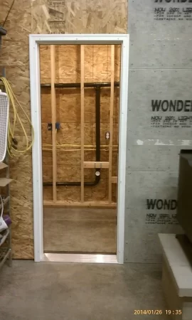

This is a mechanical room in my shop. Farthest left is the 2" drain for a greensand water filter, then a pair of connections for the sink, and then the toilet. It's hard to tell but there are two drain lines out of the building combined to a single vent stack. That dual drain is why I have two sink drains. I wanted to be able to have a sewage outlet for toilet waste and a greywater outlet for greensand backwash. I want the sink to be able to go to either so I have dual sink drains.
The crazy red plumbing pipes are 6 loops of heating pex all connected together for a pressure test.
