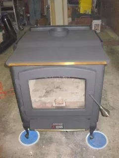

Appears to be in good condition... if i drive way the h&^% out to that end of the shore to buy it, what should I be checking?

These stoves aren't known for many structural failures, but it never hurts to give it a good look over for cracked welds, cracked corners, etc.
Wouldn't hurt to take a metal square w/ you, and check the top and sides, etc, for straightness. From the pics the color looks pretty uniform, but in person I'd be looking for signs of over firing where paint looks whiter in places. If they are trying to hide that, you'll find darker paint elsewhere on the stove, perhaps some of it may wipe off on your hand if spray painted and not heated to cure, or you'll see signs of brush marks if brush painted.

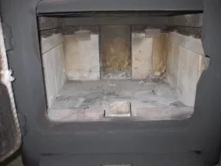

Other than that, look at the baffle boards. They can withstand heat like and SOB but won't withstand one evening w/ a drunk who thinks he knows how to run a wood stove who happens to have a fireplace poker in his hands (long story).

The stuff about baffle boards with a 30 is that the two boards together aren't wide enough to seal on the side. It would be that way if you bought one brand new. As to tubes all of the stories about them falling out I have seen is two about 13-NCs.

Make a trip out of it and go! I had to take a 10 hour trip for my insert but a good deal + gas was still cheaper than anything around me. Looks like a new coat of paint so I'd make sure they aren't trying to hide anything.
Edit: I may be wrong about the paint. A closer look, looks like there is still a sticker on the ash lip. That may well be a stove that wasn't used much.

Thats definitely not factory paint. Thats way to "Matte".
The "sticker" is just a little metal warning plate that can be covered with masking tape and painted around.
Everyone brought up valid things to look out for. But the paint isnt original. That looks like the BBQ paint Rustoleum makes.
Stove Bright isnt that dull. Maybe they spilled some water on the top and wanted to cover the rust?? Paint isnt that big of a deal anyways. Especially if you end up painting it a different color. I heard the 30 looks good in Brown!! ;-P
