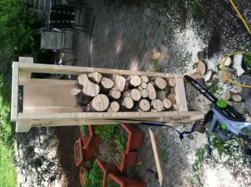

    I ordered an Earthwise 16" electric saw ($70). We'll see how it goes from here. At some point I may also pick up a mitre saw as well; every so often I have a project where I wish I had one.
  6. jkranes
    jkranes
    Member 2.
    Jan 30, 2012
    36
    8
    Eastern MA
    Success!
    bodhran, Ashful, HDRock and 2 others like this.
