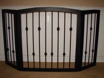

thoughts on this?

My thought is that if you could secure it to a wall it'd do fine.
Of course you'd have to move it for every re-load.
If it only had a door in it, it'd be…..a hearth gate ;)
Seriously, I've never once regretted buying the hearth gate.
Good friends used a fireplace screen for a while (just occasional fires in an open FP), but once the kid started getting rowdy they went to the hearth gate.
