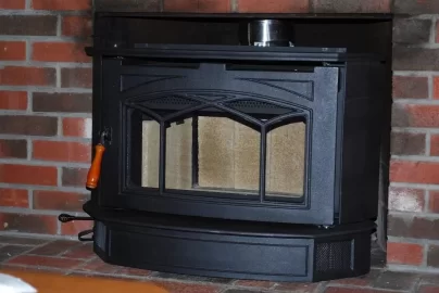

The stove will come with a Flue connector bracket. My installer inserted the liner directly into the connector bracket and tied in with three screws. No need for the optional flue connector kit IMO. Here's a pic. Follow my install link for more visuals of the install.

Thank you! Great photos - love the one of the guy standing on the chimney feeding the liner down! I also love the idea of running the extension cord down the ash dump. I hated the idea of the power cord running around the hearth. This will be a much cleaner look. I ordered the stove today. They'll hold it until I'm ready for delivery. Unlike you I'm paying to have it delivered ($50) but I'll do the installation myself. Hampton has a sale going, so I'm saving 300 something dollars on the fan, and with your tip on running the cord I'll save another $45 since I won't need the conversion kit to move the cord to the other side. Looks like I may bring this whole project in right around $3k, which is about a grand less than I expected. Life is good!
