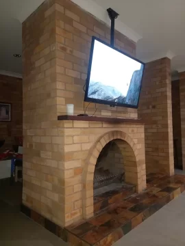

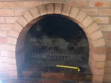

Going to be putting this woodburner insert into the existing open fire place and wanted to know
1. If its ok to block off the smoke shelf opening with sheet metal and insulation on top of it.
2. Do I need a flue liner or can I just run the flue up a meter or 2 through Mr blocking plate and why.
3. Do I need to line the inside walls with insulation or anything or are the bricks ok. Thank you
Also this fireplace is in the middle of the living room and not connected to any external wall, you can walk around the whole thing.

Yes, you can block off the opening with sheet steel and insulation, ensuring your insulation is fireproof. In fact, this is a necessity as the heat will go up the chimney otherwise. I would also recommend a fan to get it out of the cavity.
You'll need a full length flue as it's illegal in Australia not to. It needs to be 4.6m in height from the floor. This will also assist with maintaining optimal draught.
You don't need to line the bricks with insulation. As it's an internal chimney the bricks will absorb the heat which will be released into the room rather than the outdoors.

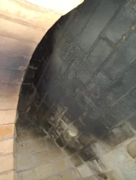

affected. Including another picture for reference. And thanks for the feedback

what does it look like in the attic and where it exits the roof. Insulating the liner is a good solution that addresses other people mistakes. I have framing touching the masonry in the attic and roof decking too.
That looks great btw.
PS have you measured everything? Will the raised firebox floor be an issue.
PPS. I like the TV mount. I did the same thing. But the tv will get hot. I’m considering flat mounting mine.

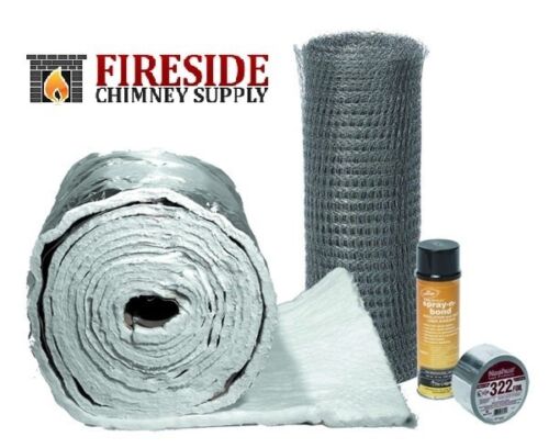

If you can't buy as a kit, then probably separate. Something like this:
Reactions: TomMcDonald
