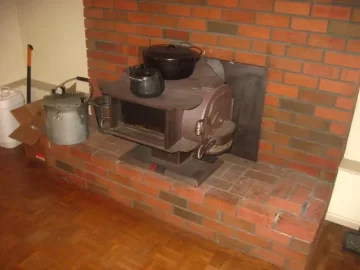

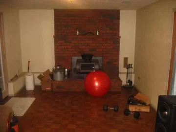

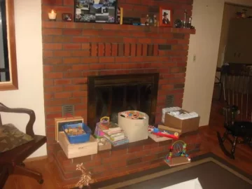

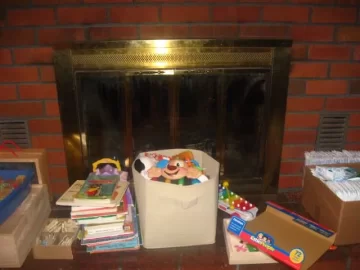

I have a fireplace upstairs and an insert downstairs as the pics show. The fireplace has a flue that's rusted open and the downstairs insert is installed slammer style. Not very good. I need to upgrade everything to make it all functional.
My wife would like a stove that can cook upstairs, that's where the fireplace with the glass doors is located. The downstairs has a bit more hearth and could easily accommodate a larger stove. I would be happy if the downstairs stove could cook as well, it just adds a little more functionality to the house.

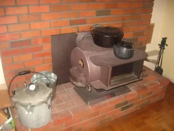

My existing basement wood stove is an Orley. Can an Orley be fitted with a catalytic? I've heard of people upgrading their equipment... just curious. If I could make it efficient I could possibly keep it.

There is nothing that is going to give you the cooking surface of that old Orley, except maybe a free standing stove. Has the Orley been carrying most of the winter heating load or is it just used occasionally?

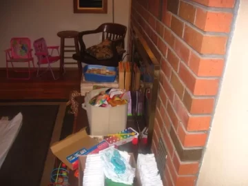

For insert options we need dimensions for each fireplace including h&w front and back and depth, top and bottom.
36" across the front, 32" high. In the back it's about 30" across and 28" high. Depth is 28". That's for the upstairs fireplace. In the basement I can only get width and height, there's something installed in back of the insert that blocks the front of the fireplace. Just a guess, but I bet the dimensions are the same. They look the same to me from the outside and they're both on the same chimney.
The Orley works like a champ downstairs, but downstairs is just basically my bedroom. A small ceramic heater actually does a better job of heating that room. My kids' bedrooms and the main living area are upstairs. I have placed a box fan on a folding chair in the hallway pointing down the stairs but that's no way to live long term. Between the narrow hallway, narrow staircase, and the folding chair I cannot get around.
It did the heavy lifting for heat during last winter. It's just such a pain to get the heat around the house that I need to do something else.
I figure the first thing to do is to get that fireplace upstairs figured out, and as long as we're in there I want to run a pipe to the basement and install the Orley right.

You have lots of wiggle room in the upstairs fireplace. That gives you several options. The next thing to figure out is how well heat is going to circulate from the upstairs insert. How many sq ft in the house not including the basement? How open is the fireplace room to the rest of the first floor and where is the fireplace located (middle, end of the house)?
The upstairs LR, kitchn,DR are an open floor plan, and the ceiling fan circulates that area well. There are three bedrooms down the hall that dont circulate well. I have a workaround, a fan in the hallway helps a lot.
