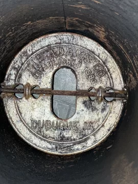

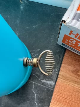

Need advice on what I think is a Majestic cone-shaped.
58ranch
Sep 26, 2026
1
Dallas
There is no identification at all inside or outside the unit. I’m hoping someone may know how this needs to be installed according to the manufacturer or at least in a way that will pass a safety inspection. The flue pipe is 7 inch diameter. Any info would be greatly appreciated.

Could be a Majestic Jupiter. Preway and Malm also made units in this style. Try contacting Hella Vintage Flame in Oakland, CA for ID and installation requirements.
Older unlisted stoves generally need 36" clearance to combustibles, which can be reduced with a heat shield per NFPA code. Those older units are very inefficient.
