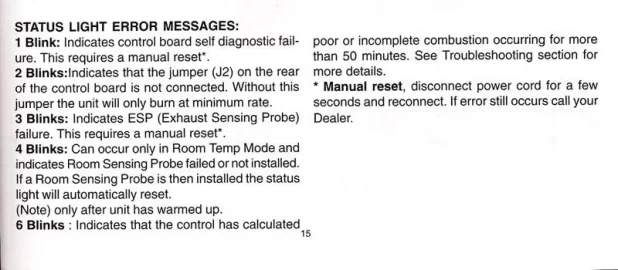

Can't find my manual, and this model's isn't on their web site. The status light is giving two blinks over and over, I need to know what that means. Someone with their manual please let me know? Thanks!!
Heres the codes on what the blinking means.
Good Luck...
  • [Hearth.com] Need answer from Harman P61A manual, I lost mine  :(
Muchas gracias, murder1! Funny though, it isn't burning at minimum, it's burning pretty much where I have it set, I think. Doesn't seem to bother it much, if at all.

AH!! Now this was it. I have the older micro-switch model, that's what two blinks USED to mean, "feeder plate blocked." I'll bend the arm back or put in a new switch. Thanks everyone, you've all been very helpful!!!
