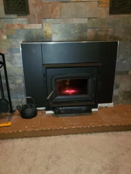

Hi i am new to the wood stove life. We just purchased a home that has a old heatelalator unit in the fire place. I purchased a Ashley hearth 1800e fireplace insert. After 2 days i already called to have it picked up for a return. It doesnt even heat the living room let alone 1800 sq ft that it advertises. I thought about a wood stove itself and not a insert. But at this point im open for any suggestions. I dont have that deep pockets but at the same time i dont want to buy junk ..... again. Any tips or insight would be awesome !

That fire is not getting enough air.
That is just coals . I gave up i burned all day and it did nothing so i gave up. Im already in the process of returning this unit. Im looking for suggestions and opinions on inserts compared to standard stoves and brands .

Post a picture of a full load with the door open.
