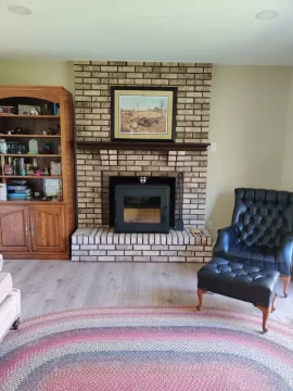

We’re looking for a new modern-looking stove to install in our existing HeatForm/Heatilator fireplace and would like suggestions. We’re looking for a free-standing stove that will fit the space. We’ve identified only a few stoves that might meet our needs/wants. They are:
Both of these units feature the ability to install them without a pedestal or legs (or a minimal one). We’re hoping to identify other stoves like these.
We also like the look of these inserts but would really prefer not to go with an insert for a variety of reasons
Background info:
We’re looking to replace the Jotol Oslo that’s been in service since 2009 on our 1st level great room. Link to the original install here which shows what our fireplace looks like.
The Oslo would get moved to the basement hearth where our pellet stove sits quietly (finally) now. After installing a new central HVAC in our house, we no longer plan to heat with pellets and can harvest cordwood from our property. The new wood stove will not be a primary source of heat but will get used often.
We want to avoid inserts because we don’t want convection fan noise and it may be challenging to fit a surround to our stone fireplace. We also like the look of the stone around a free-standing unit.

The Stuv 16 cube is a contemporary freestander. There is also the MF Fire Nova series.
Reactions: semipro
The Oslo had short legs? So you need something under 28”? You are planning on top vented stove inside the the fireplace or out in front and punching a new hole?
Yes, the Oslo has the short legs and the peak of the masonry ark is at 29-in.
We plan to top vent. The Oslo now is top vented.
Choices will be slim with that height. Mf nova comes to mind. That’s not a recommendation just an option. Jotul f45 but I don’t like how you would have to clean it. So that would get scratched from my list.
Does Woodstock make one that short for hearth install?
Random thought could you just buy a clear front door for the F500?
Reactions: semipro
I just installed an MF Fire Nova 2 on my hearth. I love the look of the stove and the viewing window is excellent. My only complaint with the stove is I cannot open the door when I have some good flames going without some smoke leaking out the top.
