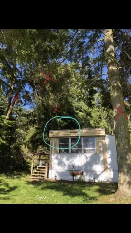

Brain. Obviously not 15’ from roof, that would be absurd- This is what I’m dealing with. The x trees will be removed, stove would be located front left in the picture.
The flue height is typically from the stove top. Regency, Pacific Energy, and SBI (Drolet, Century, Osburn) stoves are generally easy breathing and will work on 12' flue system.
