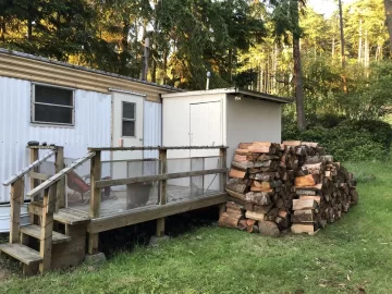

The mobile home has a mostly flat roof, except the front room which has a slight horizontal pitch, and the stove chimney will go through the pitched part. At its highest, maybe 1 ft above rest of roof. (See photo)

Doh. More than one foot…18 inches?

To meet code you will need to be 2' higher than anything within 10' or 3' out of the roof which ever is higher. But most stoves will need at least 12' above the top of the stove. Some need 15'
Reactions: Huckpoten
Looks like you will need a short, cathedral ceiling support box for the chimney. My guess is that there will be about 6' of chimney pipe above the roof to make 12' above the stovetop if the Century, Drolet, Regency, or True North stove is selected. The chimney will need a roof brace at 5' above the roof. This is especially important with the high local winds.
