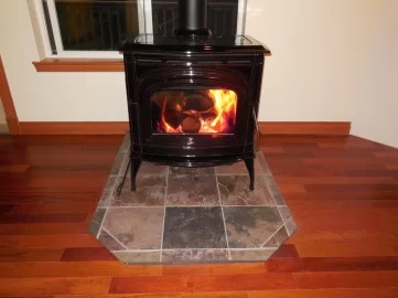

Here's my recently installed Ashford in brown enamel.

I'm just beginning to get used to it but already I can see that it can do very long, slow burns. Today I would add a chunk of wood and it would burn for hours. With long slow burns, heat can penetrate through the house, at least if it's well insulated. It's certainly a lot colder where you live than where I do. But this stove is designed for homes as large as yours and larger. Can't tell you how glad I am to have found it. Of course I'm on the west coast, in Washington, where these stoves are manufactured. You'll have to see if you can find a dealer who can sell and service your stove.
Maybe it's just my eyes but what is sticking out on the right side(facing the stove)?
Air adjustment or bypass?
You mean the door handle? There is a cat bypass handle on the right too, but it's not visible in this photo.
