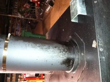

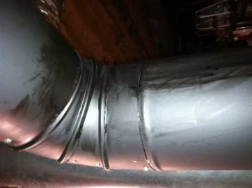

Ok this is the 2nd time I have bad this. Bad my stove 2 weeks and I'm sure it's operator error but this time it's affecting the fam. I came down after work At 530 and my englander 25-3800 bad super hot coals so I reloaded it. I have been playing with the drafts trying to maximize the burn times so this time I turned them both all the way off and then just cracked the front wheel draft. At 745 I started Smelling a wet wood smell like after you put the camp fire out for the night. So I jumped up. It was all of a sudden. House was good and warm. I'd say 77. I came in the basement and it was stronger down here. I immediately saw the flue pipe leaking water. It was coming from the elbow but also bubbling around the pentagon shaped insert where the flue pipe goes into the stove. The window showed hot coals but the wood was charred black and not burning. I grabbed my IR temp gun and the flu temp was only 119 degrees. I had starved it I guess. I grabbed a shirt and wiped up the dark water. It's mostly water but its sticky. I immediately opened the drafts and it flamed up. All of the leaks stopped Immediately and what you see below Is how it is now. Keep in mind that my chimey even tho 30 years old has only been used for 2 weeks. I'm nervous because I don't know what this is. I don't want to sit down here with a garden hose at the ready but at the same time, I think the temps got to low causing condensation. The wood I loaded up was damp. I am reluctant to let you all know this because I do t want everyone to say " there's your problem you idiot " but I don't want to leave anything out. It all dried up and stopped within 30 seconds of me turning up the drafts. Wife and kids are complaining of the smell. Thanks for all the help.

The more I think on it. Was the flue temps so low that the steam from the damp wood couldn't evaporate causing this ?
Condensation sounds right to me. We can skip the "you idiot" part, but yes, the wet wood and air-starved fire is probably your problem.
good morning heath, Your not a idiot by far. your just learning. When you load your stove up with fresh wood, its a must that you let it eat for at least ten minutes to start the drying process of the fresh wood and to aclimate it to the internal stove temps. What happened when you did that, you made a smoker. thus all the creosote. Your flue, still a 90 degree angle? that flat run that you have is not good for draft, 45 it. Feel free to call, more than willing to help. 816 383 4506

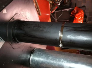

no it does not. Could someone post a pic of a flue at 45 coming out of the TOP of a stove?

outstanding man, thanks for doing that just for me. Nice stove as well.
That is not a professional job with the flue, but it's safe. I don't know if you are a car man, but like the guy earlier was talking about car exhaust, I was not specifically, speaking about the exhaust but, the principle that I am tlking about translates into so many facets of life that we never see. Real simple, cars come stock with exhausrt manifolds, people want to enhance the flow characteristics, by replacing the standard exhaust with headers, Smoother flow, you may not think that the 90 in your flue is bad but , it is Guaranteed slowing the draft down, especially with the horizontal run directly after the 90degree elbow. I have spent burning more things in my stoves smoke free than most could imagine. Smoke free, have you. Like i say on many of my videos, if there is no smoke, it is physically impossible to have the creosote that can catch fire. yes, i have creosote, but it is straight carbon. Feel free to call me any time, more than willing to help. I hated the first stove i bought for half the first winter. I had them come get my gas meter, I had to make it work or I wood freeze. then ifell in love with it. but hated the smoke that came out of it. I build the first lava rock stoves. One day my friend, peace
You have creosote. It appears you are burning wood that has a high moisture content. It also appears you are burning too cool as a result. Complicting the matter is the fact that you do not have a 6 in. liner in your chimney, which would greatly improve draft. Already mentioned is the elbow.

I posted this in one of your earlier threads:
"Check early and check often for creosote, my gut tells me you may already have some.
A chimney fire is no fun.
And remove the wood shelf, it's combustible, and my bet is that it's proximity to that stove pipe is not up to code"
From what I believe to be your stove's manual:
F. Creosote
Creosote – Formation and Need for Removal When wood is burned slowly, it produces tar and other organic vapors,
which combine with expelled moisture to form creosote. The creosote vapors condense in the relatively cool chimney flue of a slow-burning fire.
As a result, creosote residue accumulates on the flue lining. When ignited, this creosote makes an extremely hot fire. The chimney connector
and chimney should be inspected at least twice monthly during the heating season to determine if a creosote buildup has occurred. If creosote has
accumulated it should be removed to reduce the risk of a chimney fire.
I would also add that it appears you have a basement install. Your setup may be causing spillage, meaning cold air rushing down the chimney. There are scenarios where the house itself is a better chimney than the chimney, and the draft of the air going up the stairs, or being sucked out of the house through a dryer vent, or stove fan, actually pulls air down the chimney, causing the odor you smell, which is creosote.
Damp wood is not the problem. Your wood is not seasoned. Your not going to get that much moisture from surface wetness.
