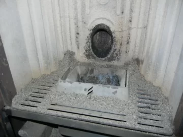

This is picture of Ecoteck Elena after firing for several times to eat a bag of decent pellets
yes that is exactly like the ash in my stove , I expected it to be more like very fine light gray but its more brown/black and sand like size but not hard .
Ash consistency depends a lot upon the pellets you burn. Doug fir burns nicely and leaves little ash, gray color. I burn cheap FSUs and they burn ashy and match your description of peppery sand.
