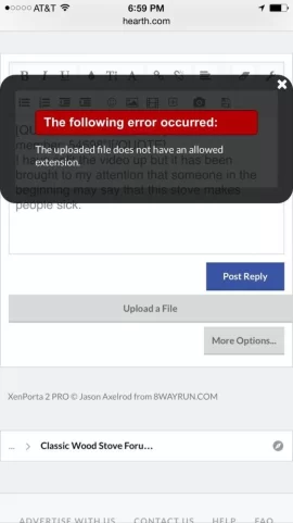

File size might be too large? Check your mailbox here (little envelope icon in the upper right top of this forum) next to your name.
I have split the video up but it has been brought to my attention that someone in the beginning may say that this stove makes people sick.
  • [Hearth.com] Need help to choose 1 of 2 Jotuls or go in different direction
Looks like it may not be a supported format. Check your Conversation mail.
