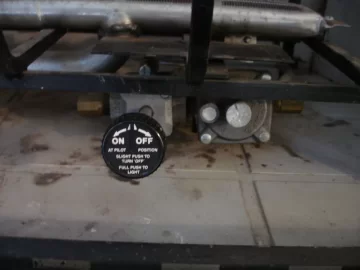

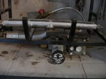

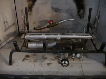

DAKSY: You are correct. I got those specs from the firebox. Don't see anything on the gas fixture itself. I will look around the local area (Myrtle Beach...I just moved here so I don't know where anything is yet). Maybe there are specs on the backside or bottom of the gas fixture...I'll disconnect it and check.
If you can't find a model number, post a pic. Somebody here may be able to ID it.
Many gas log sets originally came with a removable rating plate, & yours may be gone.
Finally got around to getting pictures. Could not remove the unit for better access as I don't have good tools with me and the gas pipe fittings are really tight. If these pics don't help I'll borrow or buy proper wrenches.
