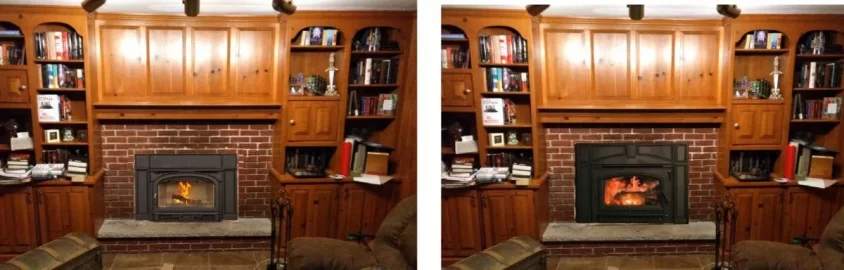

The oddball competitor is the Travis Large Flush. This actually fits a bit better than the Quad V. Grand but with the options I'd want on it, it's about $2000 more than the above two, and I think it might be a bit too much for our space, especially as I'm thinking heat will only easily flow into the 1000 sq ft of communal space and not so well back to the bedrooms. Then again, I don't think it would *not* be enough. But almost $7000 installed (with the artisan faceplace and custom sized surround options) is more than I'm really comfortable with for a first stove.
Below is a pic of the current fireplace (going to reface it and stain the bookshelves a dark brown), along with a really crappy photoshop mockup of the two units installed

The looks and everything are subjective, I know. I guess my main concern is the heat. I hear of some people's installs where they say that a decent mid-sized unit like either of the above can barely heat the room it is in. I know a blockoff plate can help, but it seems like insulation makes such a big difference on an external chimney that it's really pushing me towards the Montepelier even though I'd generally rather have the Voyageur Grand if I had a big enough firebox to insulate with it as well... although that low secondary tube in the Grand really bothers me (not sure why but I can't seem to look away from it).
