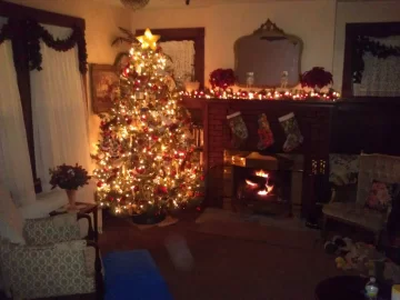

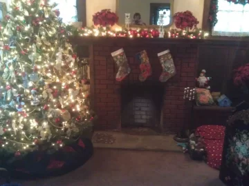

I know this is the Wood Shed forum but thought my topic would get the exposure of a lot of people whose opinion I would value here...I also posted a thread on the Wood Stove and Fireplace forum...I'm shopping for an insert. the wife doesn't necessarily want a wood stove with the exposed pipe although I'm not opposed to the idea...I'm contracting a most reputable company, they're coming by this evening, I'm sure they will have good recommendations but I want to hear what experienced users have to say...here are a couple of pictures of the Holiday hearth...thanks...

I could be wrong, but I don't think you'd find an insert to fit in that small space. I wonder if there's something made in Europe for that?
Don't see it happening bud sorry...
I am afraid you will be making that opening larger if you want an insert in there man. How could you stay in that room if it were a fire in there anyway? It looked like a small room from the picture.
I'm not against having the opening enlarged, we'll see what the chimney guy says...the room is actually quite big, I'm standing in about the middle...thanks for your comments so far...
Well I would have some recommendations, but first I would like to know your measurements. Could we get the opening width, height, and depth? Also how wide and long is that slab in front, need to check clearances.
You might want to look at "sort-of-inserts" such as THIS Regency (that I highly recommend.
The minimum opening needed is 28" W x 21" H.
The only thing I can say for sure is that next years Christmas tree will have to find a new home.
Also, at first I thought I saw a ghost, then realized it was your reflection in the mirror.

25 1/2" wide 30" high 12 3/4" deep...chimney guy is just leaving now...had chimney cleaned and video inspected...if we go with fireplace again will have it deepened and get stainless chimney liner...will decide when they give us recommendations...we're basically just heating the big living room...rest of house has water radiators except for basement where I'll get a wood stove (one day)...that's not what she said...
