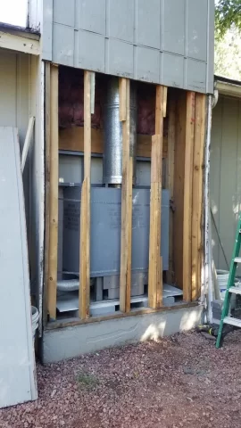

I've opened up the back of the chimney, and wondering where I stood insulation. The box says three quarters of an inch clearance, and I can have that however there's no insulation in the entire chimney, help? Please ! any advice is much appreciated!

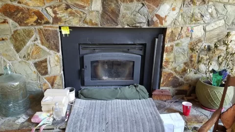

Sorry you have having issues. It's a good fireplace, so let's get it working right! The first thing is to fix the door gasket. I have seen some other PE stoves where they went shy with the gasket adhesive. If this is the case, it can leak air. It's a pretty easy job to reglue it. Use red or black RTV adhesive. The chimney pipe looks like it might be Class A, but it is hard to tell. Is there a label on it that you can post a picture of?

There is a damper control on the inside, but moving it does not change the airflow because the braided rope does not meet the Firebox properly to form a tight seal. (As told to be by a technician)

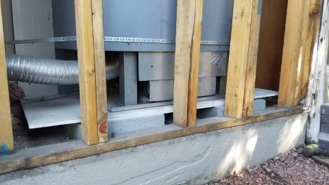

My primary concern right now, as I have the back of my house opened and it's supposed to snow tomorrow, is putting rock wool on the inside of the chimney keeping with the clearances listed on the firebox. The footprint of this chimney is roughly 2'x6'. I plan to insulate both short walls (2'wide), the removed wall (6'wide by ~8'tall) and create a "ceiling" just with rock wool 36" above the top of the firebox. The rock wool I got is rated "fire resistant to 2000F". I want to do this because the 2(80cfm) blowers (second pic: last metal thing at the bottom above the cement board to the right of the duct) just pull air from this uninsulated cavity and blow it into the house. It may as well not even have the back on it as it's just blowing outside air!

Yes, there is a damper but moving it around does nothing to slow the burn. The technician that came out said it's because the braided rope doesn't meet the box to form a seal.

Yes, you can insulate with rockwool batts, but they will need nylon string or wire zig-zagged across the interior faces to stop them from falling out toward the stove.

Judging by the black soot on the left side of thee door I wood say there is a good chance the gaskets are leaking especially if the wood is dry enough. Also is that air cooled chimney?

It definitely looks like air cooled
Yes: an employee of the installation co said the braided rope on the door "was installed improperly. that's a manufacturers defect."
