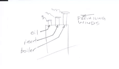

I got a new 8" flue installed in my chase today (still has to do the chase cover next Tuesday).
The installer is also going to adjust the chimney heights when he puts on the chase cover.
For whatever reason, there is negative draft going down the cold flues in the basement. It's always been that way. Have no idea why.
Checked a lot of things. I've been fighting a smokey odor on wood smoke coming down the oil burner and out through the baro damper, which I slowed down with an automatic flu damper. The smokiness coming down the 8" flue is real bad so I blocked it up until, hopefully, I get a wood boiler installed.
Anyway, I plan on having the guy adjust the three flues' heights so that the wood boiler is highest, insert next, and oil flue lowest, in the direction of the prevailing winds. My scheme kind of depends on the prevailing winds, but I feel that generally, there will be a fire in the boiler all the tie during heating season and will float above the other two, and the insert smoke will float above the oil flue. As long as the prevailing winds hold.
Waddya think?

More details (how tall, insulated flues, how tight is the house, etc)......
If the prevailing winds hold in your favor, it couldn't hurt. But unless you are on the coast or have an obstruction on one side, it is really hard to say the wind will always be from a certain direction. Have you tried letting in a little make up air (crack a window) before opening the insert......sometimes this helps with getting downdraft.

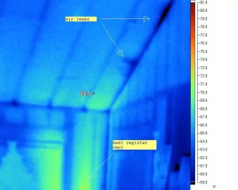

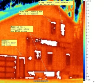

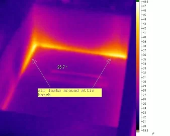

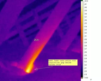

An Infrared camera can show where conditioned air is leaving the house to the outside or into the attic. It can also find the main points of outside air coming in. You can't "see" hot or cold air but you will see the temperature effect on the materials next to it.
You should be able to see any significant air leak by pointing an IR camera around the attic inside perimeter.
Finding where the air is leaving could help reduce the problem of smoke coming in with the resulting makeup air.
Maybe the attic access hatch leaks?
I put a couple examples of infrared helping to locate thermal and air flow issues and what it looks like.

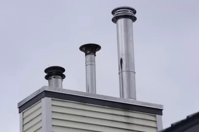

To kind of round out this thread. The chimney guy just now completed the job. I took pictures of the nice stainless chase cover, but wouldn't you know, I didn't have a memory card in the camera. Anyway below is a picture of the final product. It was my concept to have the heights graduated because of smoky oder from downdraft in the flues and prevailing winds. The tall one is the 8" chimney with a 6" insulated liner for the pellet boiler. The middle one is for the wood fireplace insert and what is seen is a single wall stainless extension of the 6" liner (was going to be a lot more to possibly match the air cooled-hoping creosote won't be an issue), and then the oil stack. As I said, world's most expensive pellet vent.[Hearth.com] Need Some Advice on Chimney Heights
