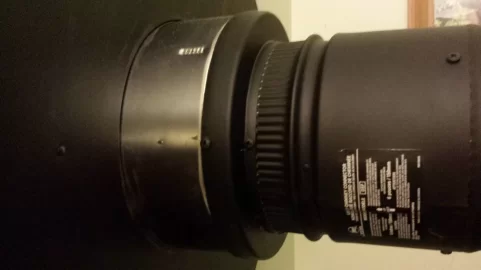

Installing DLV to a Selkirk Class A chimney(I know your not supposed to but it says somewhere in the instruction you can install it to another manufactured chimney). Telescoping pipe will not slide over the adaptor but the extra six inch DVL I ordered will. Is it ok to attach the six inch piece of pipe to the top section of the telescoping section? It doesn't have the same fit on the inside as the bottom piece of telescoping pipe does to the stove adaptor. Also how important is it for the stove adaptor to fit tight on the flue collar? It will fit after I notch a place out for the pipe in the stove flue collar and will go all the way over the flue collar but its not tight at all. Sorry for all the questions and long post but I want to do this only once. Pic is of top telescoping section attached to the extra six inch piece I ordered.

This is the adaptor I have. It twists into the Class A and then it and the class A and adaptor sit down into the ceiling support box. To remove this adaptor all the pipe has to be pulled to remove it

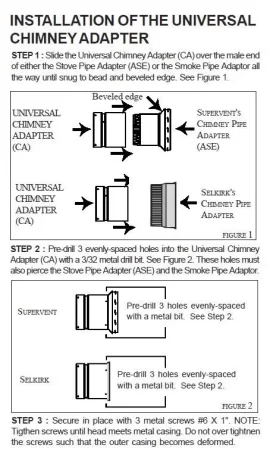

So your saying the is another adaptor that will side over this one (after its cut off some) that the Selkirk double wall will attach to. This is the only adaptor northline express sells for DSP

yes, but everyone does it all the time!
either a metal best dsa or the dvl chimney adapter, or the security chimney adapter can work
Some, may do this perhaps, but by doing so they void the warranty of the stove pipe system, right? Are the customers told this? As we are seeing mixing brands also adds complications in securing the connection.
