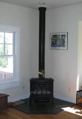

wood stoves definitely are great for heat. I replaced a ventless gas firelplace with a hearthstone tribute in a florida room. That room is 30 degrees in the winter, but with the stove going for a few hours it gets up to 68-70. My issue with a stove in the family room is I don't want to see the pipe/chimney. I would rather have it hidden and put cultured stone up to the ceiling.
well I was trying to post a pic of the tribute but I can't figure out how to resize it so forget it.

you're right gooserider, I just looked at the gallery of pics on here. The pipe doesn't look as bad if there's some kind of stone or tile behind it. Good idea.
ps. I figured out how to resize my tribute pic.
  • [Hearth.com] need some help
Ah, great picture. Now I can see why you are concerned about the piping look. That is a pretty dominant pipe on the Tribute. What's the area where you want to put the other stove like? Can you post a picture of that spot? Will the pipe have to have a long offset like the Fla room or will it be able to go straight up?

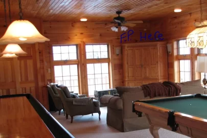

First of all thank you for being so helpful. Here is a pic of the room. Currently there is an entertainment unit in that corner that I will remove. The room is on the first floor with a bedroom above. I guess I could run the pipe all the way up through the bedroom also. Maybe box in that corner? Or I would have to have it go outside before the ceiling and run up the side of the house. I know it has to be something like 3 feet above the roof line. What do people usually do with their chimney pipes that are exposed outside? It's one thing to come out the roof, but going up the side of the house is kind of ugly.

Yes, you could do a box in the corner around the pipe. You'd have to use the right grade of pipe, and there are clearance requirements, but they aren't unreasonable. As long as you are willing to give up the floor space in the bedroom, this would be the best way to go, as interior chimneys are much better functioning than exterior ones, and it gives you that many less bends, which is also a good thing.
The only issue, which would still be a problem with an outside pipe, is how high / steep is the roof over the bedroom? The pipe is going to have to stick up at least high enough to make the 10-3-2 rule, which could be pretty far if you have a steep pitch roof. (10-3-2 rule = 3 feet above the roof where the pipe comes out, and 2 feet above any structure within 10 feet of the exit point) Tall stacks aren't a big issue to build, but they do require bracing and possibly the addition of "crickets" in heavy snow areas. Neither is a huge issue, but they do need to be planned for.

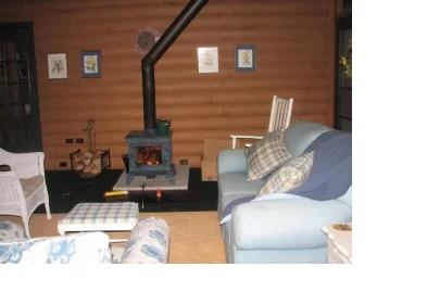

PS: Here's a shot of our Castine in a corner installation.
that's a nice stove you have. The room is 527 sf. but lots of windows. Far end of the room has stairs leading to a bedroom. Can I expect any of the heat to radiate upstairs? The stove will be at the oppostie side of the room than the stairs. I am basing my choices on the two fireplace dealers in the area. Neither has Jotul, pacific energy. I did look at the quad isle. I like it but it looks expensive. Yes, I would like the combo of this stove and my Lopi Freedom to heat the whole house if possible. Having to tend to two fireplaces is no big deal since whenever we are at the house we are on vacation.
Yes, some heat will head upstairs assuming there are no blockages like doors in the way. Given the room size, getting too big a stove might drive you out of the room. That cancels out the Isle Royale, but the Quad Cumberland might work. What is the nearest big town or city? There are a lot of PE dealers listed on the PE website for PA state. I think an Alderlea T5 would be a nice fit. Actually the Jotul Castine we have would also work well as might a VC Encore catalytic stove (with greater corner clearances).
