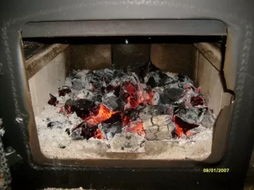

The first is the bed of coals that I was starting with for the night. It takes alot of wood fed pretty regularly to make a good bed of coals.

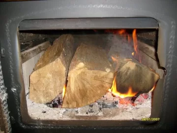

Next go in the 3 big splits for the night. When burning pine, size matters. Alot. And laziness prevails when splitting.

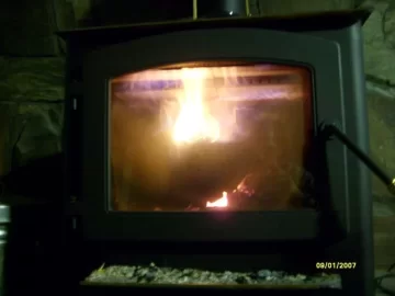

10 minutes later, the secondaries are rolling, the stovetop is 500ish, and the air is shut down to 5-10%. Bedtime

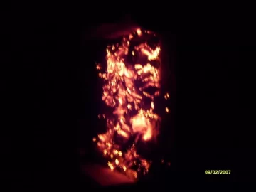

8.5 hours later, COALS!!! Normally, I'll have less than this, so I prolly turned my air down more than normal. Stovetop temps were still 200, and the fan was on low all night.
