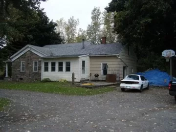

  • [Hearth.com] Negative Stack Effect?

When I replaced the smoke detectors upstairs last weekend, or opened a window upstairs this morning, and it's 10*F or so, I still notice air coming in, not going out. This morning was even before the insert was running. No smoke problem, but a little while ago when it was warmer I think the wind shifted and I got a little wood smoke in the basement.
