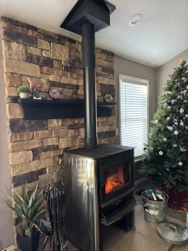

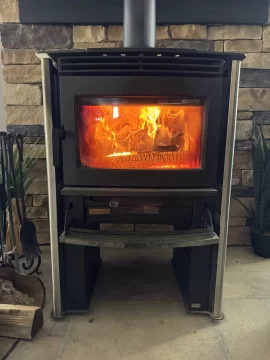

Here we are close to the end of 2024 and I find myself browsing forums for exactly what this one mentions. We purchased another house over the summer and it has a 2018 Pacific energy NEO 2.5 freestanding wood-burning stove. I too am experiencing many of the issues described in this post. Hard to start fires unless the door is kept open for 25 to 35 minutes, dark black glass in the left hand side, and smoke pouring out of the entire unit while trying to get it started. Mine does not have a blower fan currently installed.
I have what appears to be about a 6 inch chimney pipe leading from the top of the stove up to the ceiling which is about a 6 foot section total. It passes through the roof line and extends an estimated 10 feet above the house. We sit a top a hill in south western Ohio and we get a ton of wind. It seems like when the fireplace starts to dwindle down, wind is able to be forced back down the chimney and pushes more smoke out into the house. Last night was absolutely horrible.
There is no baffle from what I am able to tell with this unit. I would think I would be able to open and close especially for this summer months when we don’t want any air coming into the fireplace at all. I have seen a few at places like Home Depot, Menards, and Amazon. Looking at my set up, I will need a double wall if I am supposed to have a baffle because the chimney pipe is only about 12 or 13 inches away from the wall. A single wall baffle requires at least 18 inches of clearance where as a double wall baffle says it can operate safely at 6 inches or more.
I have cleaned the chimney with the brush that the former owner used and pulled out probably the equivalent of a small 4 or 5 pound bag of sugars worth of creosote and what not.
I have a moisture meter, however, I need to become more familiar with the wood types so I can more accurately determine the moisture content as the meter I have has different levels for several types of wood. All the wood that I have was already split and seasoned by the previous owner.
I also have a universal blower that I would like to attach once I get all of these weird issues straightened out.
Does anyone else have a baffle installed on their NEO 2.5 or have any additional tips for this model?
By baffle, do you mean stove pipe damper? That will not correct a wind forced down draft situation. Where is the chimney located on the roof? Can you post a picture of the house that shows the chimney location in relationship to the roof and house orientation?
That is a decent amount, was the cap cleaned also? Does the cap have a screen?
Thanks for the quick reply. Yes, damper is what I actually meant. Not sure where the heck I came up with baffle. The cap was not cleaned as I think it’s going to be a challenge to reach. Not impossible though as you can probably see from the pictures. It might have a screen on it as I tried to look while zooming in.
Let me know if I can provide any additional info. I really appreciate your quick reply!

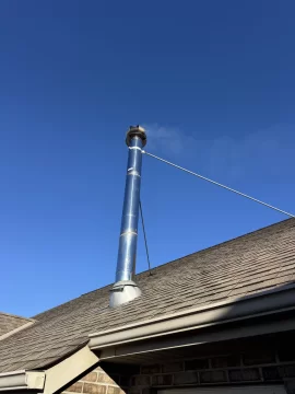

[Hearth.com] Neo 2.5 hard to get going - ? insufficient drawm[Hearth.com] Neo 2.5 hard to get going - ? insufficient draw
That looks like an odd combination of stove pipe.
Looks like inside it might be roughly 6 or 8 inch and outside 10 or 12 inch stainless. I know the inside is done this way for easier cleaning since it is so difficult to get to from the top, down. The previous owner disconnected it from the inside, wrapped a bag around the upper portion and then runs the brush up through the remaining sections all the way to the cap. I also did it this way a couple of weeks ago and did not have much of a mess inside at all. Here’s a picture of the front as of right now with the stove going.
It looks like single-wall inserted into double-wall pipe which is a no-no. My concern is the potential for air leaks due to poor sealing. Also, single-wall stove pipe has an 18" clearance requirement to combustibles. Does it have this to the mantel shelf and possibly the studs behind the brick veneer?
