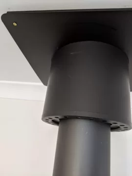

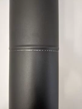

When the installer put it in yesterday, I was immediately concerned with 2 things: he used chrome screws for the flu collar which just looks cheap, and I noticed a gap in the paint at the flu joint - silver showing. He said I could get plastic caps for the screws (thats just how they come apparently?!) and that the gap in the flu would go away with first heating. It hasnt - in fact its probably gotten worse.

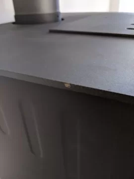

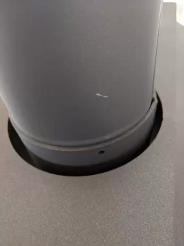

After that call last night I noticed multiple scratches on the flu, and scuffed off paint on the heater as well as a chip of paint off the handle. The flu collar install also resulted in black marks on the ceiling - looks rough.

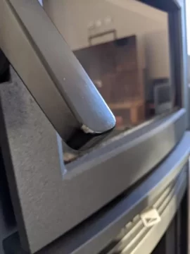

I can see the reasons for your frustration. Some will be easy for them to touch up. The handle chip will need to be discussed with the dealer. It's hard to say when this happened.

The handle looks like it was banged and damaged. When this happened is unknown, but it sounds like it needs replacement. There is no good touchup for that. The latch mechanism is simple if this is like other PE stoves. Is the latch receiver a simple V notch?

no the receiver is a round rotating barrel if that makes sense. Do you think thats normal to have the flu join so visible with metal showing through?

The cosmetic issues can be touched up. The important safety issues are the door not closing tight enough and it looks like the stove pipe was not screwed together nor attached at the flue collar.
To do this right will make several more visible screw heads. At least three at the stove and three at that mid span joint. Hopefully he uses black screws.
