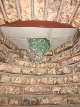

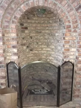

Thank you all for taking your time and lending your experience. I bought a home with gas run to the vacant fireplace. It is a rental unit in the house. When I light the gas under the fake wood, it smells like gas as it should . I guess because no proper vent and open to the room is the problem. It measures 64 high 34 wide and 24 deep. I don't want to spend the money on a stove. Can I install a vent hood and make it work ok and what type? I'll listen to all suggestions.

The chimney needs to be unplugged to start with.
View attachment 240437 View attachment 240438

Can you post a pic like the 2nd one but with that screen removed

Am I reading that there is already a ventfree set up in the fireplace or are you looking for gas insert options to fill the space?
What is the state of the chimney itself?
