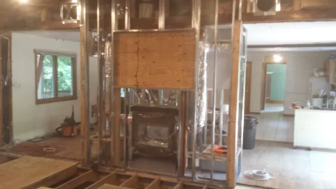

Just bought a new house that had a nice wood stove in the kitchen but nothing but a blank wall on the other side witch backs up to my great room.. the stove itself is in good shape but the liner was shot, and if you wanted a fire place anywhere it should be in the great room.... I searched hi and low trying to find something two sided and efficacy was my main goal.. I want to heat the house primarily off of wood and also be a focal point of the great room and kitchen..so i ripped everything out and bought the supreme duet.. But it seems they are so new to the market that there are not even any reviews out on them.. Anyone out there install one yet or seen one run? I cant wait to fire this thing up!! I'm just about ready to start closing up the walls and start my Eldorado stone wall!!
Here are some before and now pics!!!
[Hearth.com] New 2 sided Supreme Duet [Hearth.com] New 2 sided Supreme Duet [Hearth.com] New 2 sided Supreme Duet
I Have intergrated closets on each side for access to blowers, temp sensors and audio equipment for TV.. also storage!

Thanks.. It seems like a very nice and effcient unit that i can heat most of the house with.. I also have ducted a 6'' pipe on each side with inducer fans linked to thermostats in 2 out of the 4 beedrooms upstairs.. So not only can i heat down stairs, i can also blow heat upstairs also!!
Looks like a nice install. I have done work with Supreme in the past and they make excellent products. Don't worry. I haven't had hands on with a Duet but it is based on the single sided version, the Galaxy which has been in service for a couple years now. I was at the factory when the Galaxy was in testing and the emissions numbers were fantastic.
Be sure to light you fire with full logs and firestarters. Lighting with newspaper can sometimes "flash" a large amount of heat at the bimetallic air control mounted on the top of the firebox behind the top louver and trick it into closing the air prematurely. I believe that they have incorporated an override lever into the new series of units so it might not be as big of a deal now (most of my experience was with the Plus and the Opus). Here is a link
With the stainless firebox the Supreme units have huge heat transfer. Be sure to let us know how it is heating for you once the weather cools down a bit.
BTW one of those "closets" would be a great place for mass wood storage.

Here are some updated pics of the install.. Hope to start getting the stone wrapped around it soon!!

Well the one side of the fire place is my great room witch is 450'sq the other side is my kitchen witch is about the same if not a little bigger.. Then two out of the four bed rooms upstairs will have ducted hits from the fire place also.. each bed room is avg, 200+/-sq.. The two grills near the ceiling in the great room, and on the opposite side wall in my kitchen are actually part of my hvac return duct, so the way i designed the hvac system on the first floor is to pull my return air from the side of the house closest to the fire place so in the winter i can run the "fan only" on my hvac system and pull all the hot air from ceiling in the great room and that end of the house and blow it evenly through the first floor.. So to answer your question, with this fire place blowing heat out of it 6 different ways i'm hoping as long as you keep wood in it, it should heat just about all 2400'sq of the house.;)
Nice work, Its good to see I am not the only one that frames with steel in my home.
