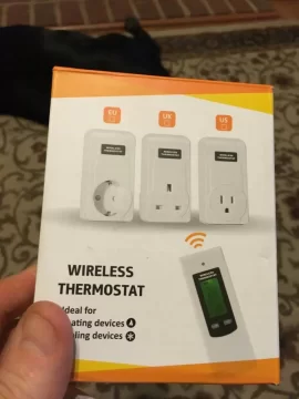

I have learned the best way to get the heat from my ashford is to use the fan. But the use of the fans dramatically reduces my burn times (do a search if you want to know why this occurs). Fans on or off was the only option at first. Then I used A simple appliance timer to cycle it on or off over a 24 hr period. It worked good. I could Leave the fans off for instance until later in the night when the temps drop outside. Mostly I used it to cycle the fans on and off on an hourly basis.
I have always wanted a thermostatic switch to make things even better. I was going to have an electrician wire the outlet to one across the room- till a co worker found found me this on eBay I think:
Very excited!!!!
I have it set for 21C (roughly 70) the fans will kick in if it gets below that in the stove room. That keeps the rest of the House about 68 which is perfect. Of course it doesn't control the fan speed, but it shouldn't be a huge issue.
Will report back
Very excited!!!!
Will report back

Found an issue- the stat operates at 1 deg above and below set temp. The stat is in Celsius- so I'm not crazy about the roughly 3.5 deg f swing in temp. Need one that operates in closer tolorances
Edit- after watching the Chinese informational video, I was Able to get to to change to f! That said it still clicks on and off at 1 deg C. So same temp swing.
