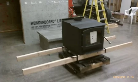

I don't "lift" stoves unless I have to. Ramps, dollies, tipping the stove to shim it up yes but dead lifting is risky.
The picture is how we lifted the NC30 onto the 18" tall hearth in my shop.

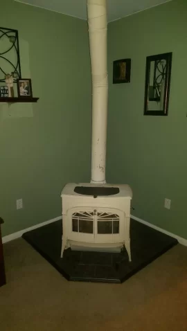

I've got a ton of ash in my stove and for the most part it stays put. Can't answer your other questions. Mine is enamel and I don't know much about installation. I will say it took a couple of really burly guys to life my stove a few feet from the dolly onto the hearth pad. It wasn't easy for them. I've got it on video and can send it your way if you want to see what you're up against. If you're coming all the way in from the curb, you're going to want a dolly for sure.

Painting it to match existing light tan stove pipe to pass WAF.
Regarding draft, I've dealt with nothing but rage with my VC. I don't know how I had such a great draft, but I'm hoping I still do with the BK using single wall.
