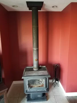

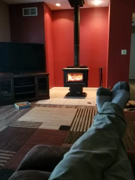

Here's setup now. It's a 2003 earth stove. Can bring house from 64 to 84 in an hour! But then it's empty lol! Only burns for 3/4 hrs at a time.
Inside flue is single-wall. Will be going on the roof in a bit for more pics.
Was also quoted a regency pro series f3500 by dealer today. These get long burns? I'm at work 14 hrs each day and having a newborn in 2 weeks. Wife will be busy so need long burns! 20191111_160317.jpg 15757517053267952986563139647754.jpg

With a straight up shot like that, assuming no hidden elbows or offsets, you might get away with 13'.
I'd just try it and see how you like it. If your Princess has chronic smoke spillage or can't turn down far enough on warm days, look into adding a brace and a few feet of pipe at that point.
I can't imagine that you'll be too unhappy with it through the cold part of the winter, though (draft is stronger then due to the temperature difference between inside and outside).
My Princess insert started life with a 12' flue, and it worked perfectly in cold weather, and pretty well in warm weather. It's 15' now and works much better in warm weather.

Nice stove spot!!! Like other mentioned, a straight up shot is the best and you should be able to squeak by with out issues to the current chimney height.
