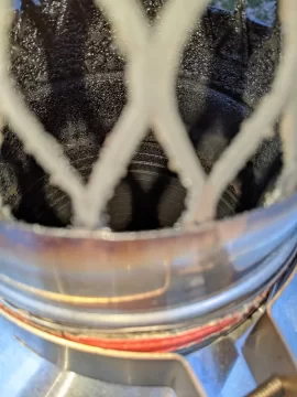

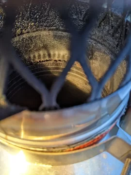

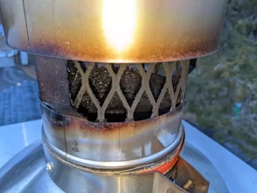

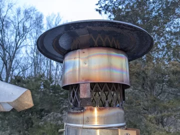

How is the build up looking? Creosote only looks shiny and thickest on the uninsulated top edge of the liner. The creosote on the inside looks like a thin powdered coat and you can still see the liner ribs. The most severe build up occurs at the outlet of the liner correct?
[Hearth.com] New Burner Check-In - Instrumentation, Burns, Build-Up [Hearth.com] New Burner Check-In - Instrumentation, Burns, Build-Up [Hearth.com] New Burner Check-In - Instrumentation, Burns, Build-Up [Hearth.com] New Burner Check-In - Instrumentation, Burns, Build-Up
The build-up on the cap is typical. The liner looks good. The Auber works. I rely on it now.
Reactions: EmberEnergy
