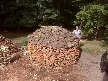

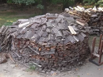

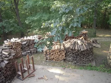

One option for storage is to create a Holtz Hauzen (wood house in german). You can store up to 5 cords in a 10X10 space and in my opinion they are a work of art. Your neighbors will most likely be interested and never stop talking about them because they probably never saw one. At my house I have almost 17 cords now and while my rows are nice, they never attract the positvie attention that my Holz Hausens get (not sure if there is a Z or an S).
Second pic is after 1 year, mostly cherry. Ash would season nicely too.
A more likely scenario is a 4 pallet HH which stores 2 and 1/2 cord.

A second to the Holz Hausen method for compact, aesthetic storage. I recently finished one & my neighbors on both sides have told me they really like it. In fact everyone that's seen it so far has commended me. If you can find 8 or 10 square feet anywhere in your yard, you can store at least 2 cord in a smallish HH. For speed of drying my opinion is that single rows are the best, but alas, we do what we can in the City. Have no doubt, if you find the free wood, you'll find the space to put it ;-)

Just a minor point . . . it seems as though the correct German term is actually holz miete . . . but most folks around here call them holtz hauzen (or hausen).
http://www.holzmiete.de/anleitung.php
For the record . . . GolfandWoodNut does have a good suggestion -- they store a lot of wood in a tight footprint and are pretty neat and interesting to see.
Every time I hear discussion of the Holtz Hauzen (or meite!) providing ability to store more wood on a foot print I wonder how that could be. I TOTALLY agree about the look being nice and it is a conversation point. Just get stuck on the math of this.... compared to just stacking in a "box" shape.
using 4 pallets in a rectangle configuration. If I stack with a HH (circle) only at 4 points will I hit the outer edge of the pallets, thus not using space in the corners. I can stack just as high, if not higher on a rectangle shape vs. a circle shape.
Again, its cool looking which may help you with the neighbors but I dont see it as providing the ability to stack more on a footprint. (unless i am totally missing a basic point - if so, someone pls explain it!!!)
Got Wood, after writing below I realized that you do build HHs so you probably know most of what I wrote below...
Got Wood, what you are missing is the heigth of the HH. On a normal pallet stack it is not recommended to go over 4 feet, although some people go up to 6 with varying success. WIth a HH you can go as high as 10 feet, although I probably only go 8 feet. If properly built, with the outside wood sloping inwards, in creates tremendous strength and the only way it can fall is in upon itself, therefore it does not fall. Poorly constructed ones will lean outwards, as do stacks, and that is where you get the problem. You can also get foot holds on the side as it gets tall that allow you to climb up, like a ladder, to reach the top. I would not try that on a 4 pallet stack. You place occasional horizontal splits along the outside edge, to make sure the wood slopes inwards. Anytime I find the wood approaching level, I put in a cross piece at the outer side.
I am 6'2" and notice how I am dwarfed by the HH.
Friendly discussion.... yes, I have built one. With the one I built, I put it on the same pallets I had previously stacked a rectangle shape with no "roof" - ended up with the same sq footage as the HH.
For arguements sake, I could apply the same building idea to a rectangle as I can a circle shaped stack. Meaning, I could built up the outer rows with the same supporting ideas, then when the "roof" is built apply the same building up concept as a circle form. I dont see why I couldnt make a rectangle shape to the same height as a circle shape.
Now maybe that would also be considered a HH? Couldnt argue that.

I managed to find a local guy who can delivery quite dry oak (claimed 3-year seasoned) in late winter and charges a premium for it. The place he stores it is inaccessible until ground is well frozen, so it's not available 'till well after the holidays. I bought a face-cord from him last Feb & it was the driest wood I bought (air closed down & secondaries flaring away). I found him by talking to other local woodburners. My advice is start asking around for a sources of dry wood, only listen to folks who've actually burned the wood for heating and consider what they're burning it in. Tell the supplier you're looking for a source of well-seasoned wood to heat your home (ie. repeat customer) & were referred by Whoever (possible discount). Explain that your stove requires very dry wood. All that may get you the driest wood s/he has. Maybe it's ready to burn, maybe not.
Lots of people around here only want Oak to burn & think it's far superior all other wood. I told my suppliers I prefer other hardwoods as they dry faster.
