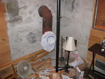

the top exit is 29.5" high. The current hearth has the exit thimble at 38.5" Obviously, I'm not going to need much pipe. Any suggestions on what to use for bends? The Castine has a 6" exit, chimney pipe is 8".

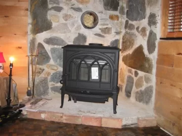

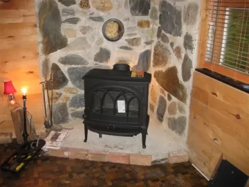

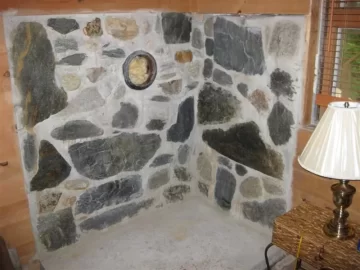

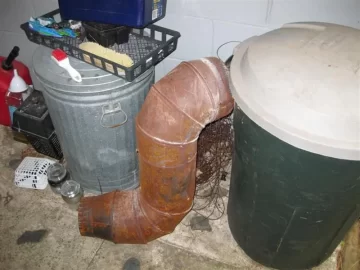

I've included some pics: The old setup with pipe (during our "move in time"...excuse the mess). The current set up; sans old pipe(and after a few hours with uric acid and a brush to clean up the cement from the home brew hearth install done by a previous owner) and a shot of the old pipe disconnected.

You arent planning on re using the single wall are you? if so, new pipe will only be about 20 bucks. You just need a 90, a split 12 and some snips. The castine is a great stove, however its a bit draft sensitve. Make sure all your connector joints are super tight and you have the proper hight and diameter chimney. If i remember correctly,. i think the manual says 15'
gratz!
Toss out the old pipe. Top exit (as opposed to rear-exit as is currently shown) for the Castine. The F400 is great heater and has nice looks, but it is a bit draft sensitive. Top venting will help. If this is a basement installation with an exterior flue I would use double-wall pipe to connect the stove to improve draft a bit more.
Edit: Synchro post with MSG.
o hell, i just looked at your other post, is that 8" ID chimney?? If so, you might have a hard time with that castine without a reline. Im not trying to plant bad seeds with your new purchase, but i have seen enough of these castines installed this way and they do not like it. If you are not planning on relining, you might go up to the oslo, its alot more draft freindly, and will work pretty well on 8".

Old pipe is getting tossed. Just put in few pics for comparison.
Thanks BeGreen and MSG. I'll be sure to look into the double walled interior pipe as an option. I'll just make sure I grab a good pair of snips before I do the install.
You don't cut interior, double-wall connector pipe at all. It must be ordered to length - double-wall, Selkirk DSP pipe. Measure up carefully because you may be able to use the DSP stove adapter (part 266243)and then a 12" + 24" length to make it to the top elbow. If not, they make a double-wall adjustable that goes from 12-18". Download the DSP catalog from Selkirk's site for parts list.

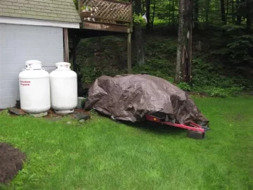

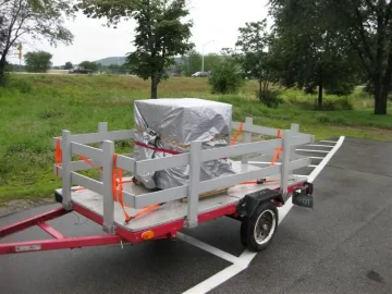

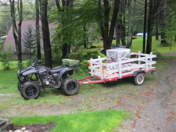

Here's some of the move. Luckily, the monsoon ended shortly after we got to the stove store. I took a pic of it on the trailer while my wife ran into the grocery store. At the house, hooked it up to the ATV...and then hauled it to the backyard and tarped it again for the night.
Luckily, we didn't have too far to go. We supported the trailer, then moved the stove off of that right onto my Crafsman ATV jack. We used that to wheel it to the door, then managed to heave/musle it into the threshold. We were able to slide it across the floor...then one last heave onto the hearth. Holy ____ that thing weights 10x more than it looks like it should. My good buddy came to help me...not a one person job!
