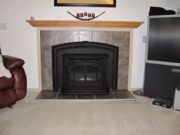

Got my M55 cast insert installed and I'm having the same problem you are...noisy auger >:-( . Everything else about this stove is very quiet. I called my dealer and he is talking to the factory. He said not to worry that they would take care of it if it needed a new auger motor. I'll be curious to find out if the new motor fixes your problem? Maybe they got a bad batch of motors because I listened to two different M55's at two different stores and they were very very quiet. My agitator was making a little noise, but after I loosened up the chain, it is now very quiet.
Flynfrfun
  • [Hearth.com] New Enviro M55
Wow!!!! Looks nice!!!! I want one!!! :-)

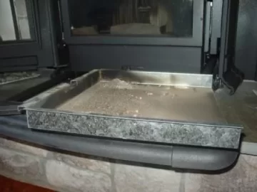

I'm still wanting someone to compare the heat output with a Quad CB1200i. Also someone please post a photo of the strange "three" sided ashpan.

AR,
Here it is. Won't be a problem if you empty your pan all the time, but if you let it go for any length of time you may be dumping ash on your hearth when you go to remove it. It just seems really silly to me. Its the only thing I don't like about the stove so far.

And thanks to everyone that commented on my stove. It took me about a week to tear out the old stove, build the concrete board box and rebuild the hearth with metal studs. It was a lot of work, but I saved a bunch of money doing it myself.
Flynfrfun

AR,
I wonder if you have to specify the four sided Ash Pan as an option. :-) Dang Economy!!!! Their cutting everywhere they can. Somebody needs to call Enviro and ask "Why" :-)
AR
Actually, the reason it is 3 sided is because the burn pot assembly hangs down into the ashpan. So, in order to slide it past the burnpot, the one side can't have a lip. It seems plenty big to me so I don't think losing ashes is going to be a problem. If you do spill some ashes, you could easily vacuum out the area.

Now I understand why it has only three sides. I knew there must be a reason. Sure looks like a small ash pan though. Probably about as big as my 1200i Quad.

When I was comparing stoves, I seem to remember the 1200i's ashpan was a lot smaller than the M55's. It had 4 sides but had smaller dimensions. When I listened to the 1200i in action, the blowers were much noisier than the M55. The fire was like a blowtorch and barely left the firepot unless you turned it up to high and then it only came out 4-6" or so. Hard to say on heat output as I couldn't compare side by side (they were in different stores), but the M55 cast insert looks a lot better in all regards than the 1200i...the fire is nicer too. The 1200i is now made in China and like so many things sent over there, there are likely to be some problems with QC until they get all the bugs worked out. Not saying that they will have problems, but I didn't want to be one of the first to find out in case they do. I liked the 1200i except I couldn't get over how "blank" and ugly the inside of the stove is. I mean you are looking at a big flat piece of steel as a backdrop. At least the M55 has a nice "fluted" steel backdrop that looks a little better. Overall the M55 is in another class as far as build quality IMHO. Of course, my M55 obviously has a problem with the auger, but this is not normal and should be fixed soon.

I didn't realize that. Guess I should have looked at that further. In any event, if that's the biggest "negative" I have so far with the stove, I can certainly live with it.
By the way, the picture really doesn't show it's scale. It's pretty good size, at least 3-4x larger than my Quad Castille has.
NPCoot is right, the ashpan is pretty big for an insert. My stove is running right now so I can't get an actual measurement, but I know it is at least 18" wide and 12" or more long. I have only put two bags thru my stove so far, so time will tell how long I can go before needing to empty the ashpan. I suspect I will end up on a once a week cleaning of the stove where I empty the ashpan at the same time.
Flynfrfun
Edit: Looking at NPCoot's pic of the ashpan, it looks like the ashes are going to pile up towards the front of the tray. Maybe they made the tray long enough so that even with that side open, no ashes will collect back there anyways. If so, when removing the ashpan, no ashes should fall out. If they do, we might be able to make a 1/4" or so lip just to keep the ashes from sliding off the tray.
Just emptied the ashpan for the first time. It is so long that the ashes don't pile up back where the open side of the ashpan is. As long as you don't tip the ashpan down and let the ashes fall out, it shouldn't be a problem. FYI, I ran 4 bags thru it and I figure the ashpan could go a lot longer between cleanings.

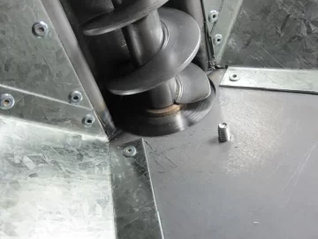

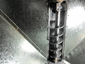

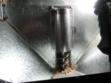

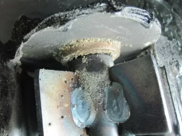

I finally got the dealer out to replace the auger motor. Unfortunately, it did not solve the humming noise. I think it may in the tube that holds the auger. Enviro said I should check the bushings on each end of the auger and to look for welds that may be rubbing against the auger. Does anyone know if it is tough to get at and expose the auger?
Kevin,
Yes, it is easy to get to the auger. Just remove the screws that hold the auger cover on. It has a slight amount of RTV silicone to seal the top, but it should be pretty easy to pry off. As you know I have been having the same problem you have...noisy auger. Mine is a M55 cast insert. I listened to your video and my auger sounds the same. My dealer even replaced my auger motor and still same problem. They had me check my auger and bushings and there was no problem. You want to vacuum all the pellets out, disconnect the auger motor and see if the auger spins free. If it doesn't then you have a problem with one or the other bushings. They said it is possible that the top bushing might not be fully seated causing binding just so you know what to look for. I will attach a few pics so you can see what it looks like.
I have been in communication with the Enviro distributor for the Western US and they sent my old auger motor back to the factory so the factory could take it apart and see what is wrong. So, I'm in a holding pattern until the factory gets back to us. I know the noise is coming from the auger motor and is traveling thru the auger and using the hopper and stove frame as an amplifier. I have an idea that would fix this assuming Enviro doesn't step up to the plate. My ideas is to isolate the auger motor from the shaft via a flexible coupling. The parts shouldn't cost more than $20 and be pretty easy to do. This is worst case scenario if Enviro chooses to ignore this problem. I've already told them nobody is going to buy this stove with this noisy of an auger, so they better figure this out quick. I'm perplexed because this is the same motor that has gotten great reviews from people on this list in the past. It is a Gleason Avery model 902 with a ball bearing supported electric motor shaft. I'm thinking Gleason Avery has changed something in their design or materials.
Flynfrfun

Flynfrfun,
Great photos. Did you take apart the housing on the auger? Does it need to be resealed once apart?
Did you spin the auger with the motor detached? Was there a noise?
My stove doesn't seem to be as loud since they changed the motor but it is still very noticeable.
Thanks,
Kevin
I removed the auger completely, if that's what you mean by removing the housing. The auger did not make any noise once I disconnected the auger motor and spun the auger. It spun very freeley. I re-applied RTV only in the spots where the factory put the RTV, which was around the top of the auger cover and down about 2" on each side. Mine did not have RTV all the way down the cover. I see no need for that anyways.
Flynfrfun
Kevin,
Mine was quieter after they replaced the motor, but has progressively gotten louder, until now it is as loud if not louder than the original one. I suspect a gear mesh problem. On my RC planes, if you run the gear mesh too tight or loose, you can get that gear whine. Either that or their motor is just a noisy motor.
Flynfrfun
I don't know how they can say that the stove is whisper quiet when it makes this hum that progressively gets worse.
I guess if I pop the motor off and spin the auger I shouldn't hear anything. If I do I can take apart the housing. It sounds like I will have to get used to the sound, but I am sure as time goes on it will get louder.
