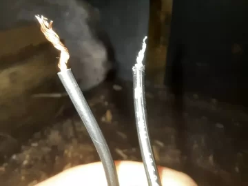

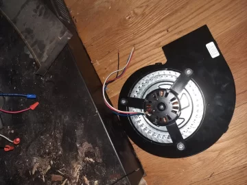

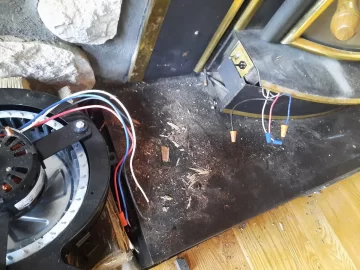

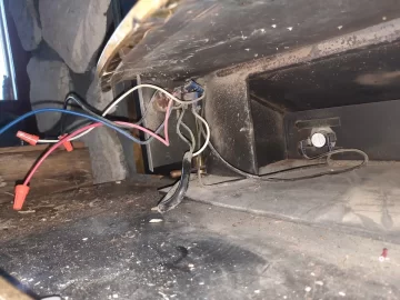

Hey folks. I have an old Grizzly 2LEX wood stove insert. Just bought a replacement fan (arrived today), so brand spankin' new. Visible in photo on left. Also n the photo, I can confirm the black and white wires coming from the fireplace insert (right side) light up my electrical tester. Black wire is hot.
When I hook up all wires to the fan, however, nothing happens. Shouldn't it be that easy? If I just hook up black-to-black and white-to-white . . . nothing happens either. Nothing happens either when I change the fan settings to low, medium, or high. The toggle switch on the insert doesn't change anything either. Top setting is "Thermostat" and bottom is "Manual."
I'm just "Bubba the Homeowner" . . . not a master electrician . . . and truly baffled on this one. Any help deeply appreciated.

Did you hook up all 4 wires?
Is there power thru the red & blue wires when the black & white are connected?

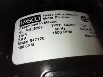

  • Plugging the white / black into a standard outlet fires up the fan as expected. Fan works. Confirmed.
  • Wiring seems to be standard fan speed where red=low; blue= medium; and black=high. When fan switch is on low, touching my tester from red-to-white lights up; if on medium, blue-to-white lights up; if on high, black-to-white lights up.

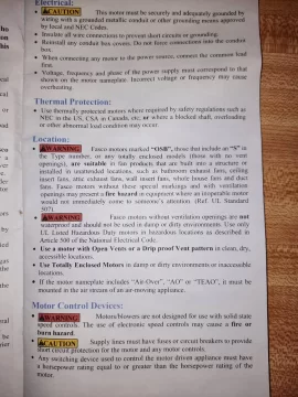

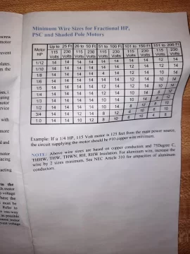

  • No wiring diagram per se, but attaching everything I gots as photos

  • Just realizing that wiring coming out of hearth is aluminum . . . fan wiring is copper . . . but not sure that should matter since touching the aluminum black-to-white was still lighting up my tester.

I would expect the fan to come on when set to manual, but not when in the auto position. If properly wired and it fails to come on then I either the auto/man/off switch is bad or the speed selector switch is bad. When in auto position the stove needs to get hot enough to close the thermostatic snap switch before the fan will come on but the manual position should bypass the snap switch.
Thanks begreen. Yeah, it's in the "auto" position and still not firing up. And I've confirmed power is traveling through the red, blue, and black wire, depending on speed setting. So I guess I'm in the market for a new auto/man/off switch + speed selector if you have any ideas.

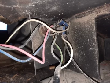

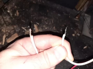

Today, I connected the black (hot) wire to the fan. After I did this, the white wire from the fan accidentally contacted the metal apron of the hearth . . . AND THE FAN STARTED WORKING . . .
For some reason, connecting white-to-white isn't completing the circuit. The hearth itself is somehow becoming part of the circuit (which is itself concerning) . . .
