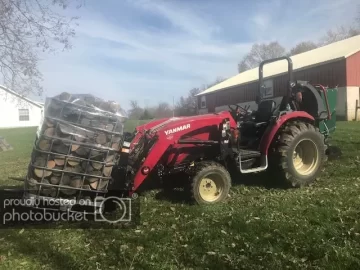

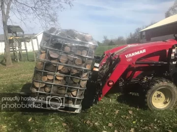

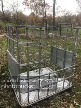

For the past 15 years or so that we have lived at our house I'd generally have to touch a piece of wood four to six times in order to get it from the woods and into the house. My normal routine was to cut the wood into 16" lengths in the woods, load the wood onto my tractor, dump the big stuff on the ground and stack the smaller stuff. I'd then come back later and split the stuff that was too big to stack. As wood was needed in the house I'd bring it in via wheel barrow or tractor loader. We have a walk out basement so I can drive the tractor right up to the basement door. IMHO - I was touching each piece of wood way too much.
This past spring we decided it was time for a new tractor after I almost flipped the old one twice putting out round bales. Part of the criteria of getting the new tractor was a machine that was capable of lifting at least (broken link removed to https://www.yanmar.com/us/wp-content/uploads/2016/03/Yanamar_2017_brochure_YT347-359_LR.pdf). From my calculations a tote of wood weighed anywhere between 1,000 - 1,500lbs depending on the species of wood.
A few months ago I made a couple trips to a local mulch company and bought twelve totes. The price of the 270 gallon and 330 gallon totes were the same so I opted for the 330 gallon totes since I could get more wood into them. By my calculations each tote holds around 1/3 a cord of wood. I'll leave the totes open up top and then in August or so I'll put shrink wrap on six or seven totes. We only burn a few cords of wood a year.
For the few days it hasn't rained and I've been able to cut, the new system has definitely cut down on the amount of times I'm touch a piece of wood. My new routine is to grab an empty tote with the tractor and take it to the woods with me along with my splitter, cut the wood into 16" lengths, split the big stuff and put it directly into the tote. I do have be cognizant of not having a tote full or splits or rounds though. I try to mix rounds and splits as I'm loading the tote. The one major down side I do see to this setup is that I cannot easily inter mix species of wood on each tote. I like to burn different species of wood during different times of the day.
Our house has a walk out basement. Now I can just take the tote with the tractor and drop it into the basement onto some moving dollies so I can move it around the basement.

A tractor can always save a couple of steps, nice system you have now. How much do those totes cost?

Good for you streamlining your opperation. Makes life alot easier.. im a firm believer in equipment..the less you handle, lift, load the better..good looking tractor BTW... l leave one or tew pices of equipment at the house here and may have 1 or 2 where im pulling wood from if its not close to the house. I grab an F550 dump to move the rounds or log lenth to the house for processing..
$30 a piece. Most of the ones I got were from 2018. So they should last a decent mount of time since they haven't been sitting out for a long time. The guy said he give me a break if I bought 20 at a shot. I however don't have a semi or long enough trailer to haul that many. I can get 6 at a time between my truck and livestock trailer.
Buying the twelve was a hard pill to swallow, but as I get older my time becomes more valuable to me.

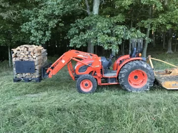

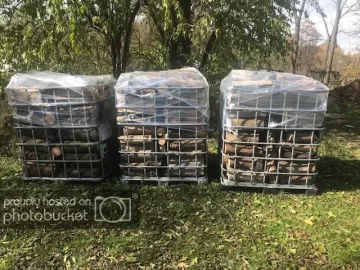

Im happy for you. In the last 2 years I’ve accumulated 36 totes. I wanted enough to hold 2 years worth of wood. Which I have ended up with enough totes to hold more than 2 years of wood. Only thing is I don’t put my heavy hard wood in them. Oak and locust still get stacked and season 3 years at least. I have a 33hp kubota and a tote of locust or oak is a bit much for it. It moves them but it’s hard on it. I also built a set of 3 point hitch forks. That helped but it still labored my tractor to lift so I’ll keep lighter hard woods in the totes.
[Hearth.com] New Firewood Setup [Hearth.com] New Firewood Setup [Hearth.com] New Firewood Setup
I’m able to carry totes into my garage, that puts the wood about 20’ from our stove. I also cut the plastic tote on a angle to make a roof. Then use bailing twine to hold roof down. I did a test this past summer to see what dried the best. I had one tote with a roof on it and a tote uncovered. In September I tested the two after being out in the sun and wind all summer and the wood in the tote that was under roof was 4% less moisture that what was uncovered. It was honey locust I did the test on. I like your set up! Enjoy

Nice setup @Slocum. I like the idea of using the plastic tote to cover the wood during the year. Unfortunately mine are long gone. My neighbor suggested putting a small tarp over each tote after I filled it but I was concerned about the wind pulling the tarp off.
I'm hoping to put a leaner on my barn this year so I can do bring the totes out of the weather in late summer, similar to what you are doing. Current barn space is too too tight to bring them inside. :(

How do you like your Kioti ? I looked at a DK45 but the dealer I was working with only wanted to sell me a machine that had been sitting on his lot for 2 years. Our other local dealership was clueless about them since they were new to the brand.

I can’t find anything I don’t like about it so far. It’s only got about 140 hours on it.

Slocum, what did you make those plastic covers from. Something like that would make a nice tarp support on a running double row of wood. Currently I use a wood frame. It keeps the tarp off the wood and allows water to run off.
They are the plastic tank that was originally inside the tote.

Isn't it a pain to dig the wood out of the totes, especially when they get nearly empty?
Greetings from another Caddy owner
I cut the a portion out of the front of the tote. If you look at the last picture you can see it. Once the tote gets to about a quarter of the way full I’ve been emptying them into the wood rack in the basement. Then when the weather permits I’ll take the old tote out and bring a new one in. I like letting the tote sit in my basement for a week or so before burning it. So far, no bug or mice problems.
