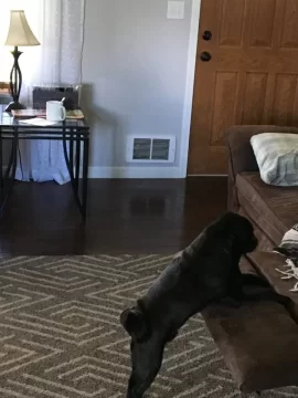

You’re not going to use the electric heat unless you are ill, out of wood, incarcerated, or otherwise unable to burn. That’s why fuel cost doesn’t matter but having automatic heat is a must.
Here is a photo of one of my little wall heaters right now. I have only turned on the breakers once to test them in the last decade. 240 volt, 20 amp breaker, a regular 12/2 wire for each one. These pull 2000 watts each and only cost like 150$.
We are 100% wood heat for several reasons. Both stoves are currently hot and it’s 63 and sunny out!
