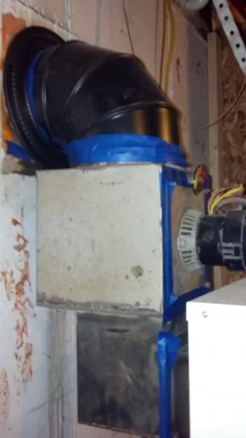

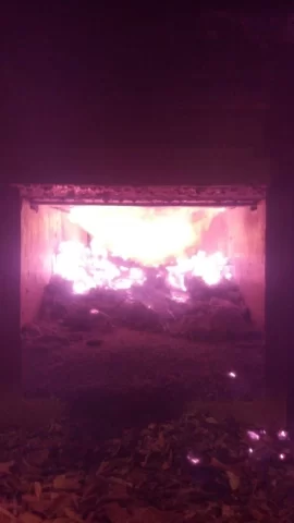

The stand comes already installed on the Vedolux 50 so I am safe. The past 3 days have been long but as of tonight I have the tank and boiler plumbed and filled (I still have to connect my heating zones). I ran into a couple things that required a little extra work during my install...welding bigger ports in my existing tank and several trips to Lowes to get me black iron cut. So since I was at a point where I could safely fire the boiler I did not waste any time before I had to go to work tonight to get a fire started. I adapted the flue box that comes with the boiler to include a draft fan which was a big help in lighting the fire and establishing a strong draft. After a short time with the fan I had a good flame then I let the natural draft take over it did pretty good. I see I have a couple leaks to tend to and need to seal my flue joints but all in all first impression is favorable. I have not wired the loading valve and controls up so I was relying on convection which worked really well. I do not have my heat zones hooked up yet so I am just heating my tanks. By the weekend I should have the heat zones hooked up and everything wired. I am in the process of locating some fin tube for an emergency heat loop but all I can find so far is baseboard heaters so far so I may have to use them. Since I am not fully installed and I do not have all the safeguards in place I will only burn a fire when I am able to babysit it.

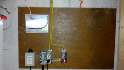

I installed my manometer today to see how much draft I was getting compared to the minimum required value in the manual. It looks like I am still a little low. During the cycle of a burn my draft currently ranges between .05 and .1 inWC compared to the reccomeded minimum of .09. I need to make sure the chimney is clean with no obstructions and my first effort will be to fill the bottom of the chimney with sand. Unless this greatly improves my draft I think I will extend my chimney by 2 ft during the summer.

Dean told me to start burning without any turbs so thats what I have been doing. The outside temps have been been between 20-35 degrees mostly about 30. I have had consistant draft readings up to .11 inwc. but mostly around .07 inwc. When I get some time I am going to fille the bittom of my chimney to see if that helps.

This is the blower box that I welded to the flue. I need to get some things sealed up...tape was the only thing I could grab when I lit it for the first time.

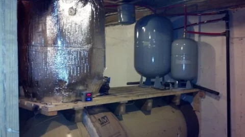

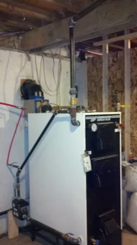

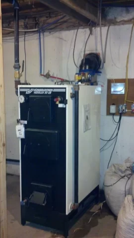

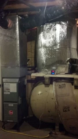

So I finally got you guys a few pictures. I still have alot of work to do but the system is mostly functional. I have some stuff on order to add my emaergency heat dump and a plate exchanger for domestic water. I also have foam on order to get the tank insulated this should help alot! Everything should be here next week.
Looks great, arngnick!
That's one speedy Varm install. My install, not so much... but I am really happy with my Varm after two months of consistently easy operation.
Best of luck with that sweet new natural draft gasser,
Noah
Reactions: arngnick
Very fast install Nick!
Why the pipe connecting the top and bottom ports in your second pic? And I would really find some tape other than the blue painters tape, that could get too hot pretty easily and smoke/burst into flames.
