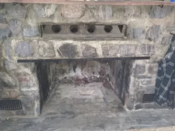

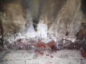

Welcome. The Superior heatform is not a ZC, it is a metal masonry form fireplace. It sounds rusted out. If so I think it is going to require taking a torch and cutting it out followed by a rebuilding of the masonry shell. You should have it inspected and gone over by a mason first. After the rebuild an insert could be installed or perhaps a freestanding stove could be placed in front? Can you post a picture or two of the existing unit? How large is the current fireplace opening?

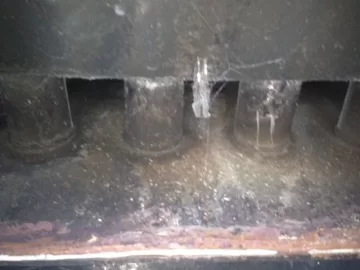

I have attached some pictures and I have examined the interior of the firebox more thouroughly (I have an appointment with a Sweep that has a camera). I will ask the Sweep if there is evidence of a chimney fire or not.
As near as I can tell all of the masonry is in very good condition. I cannot significantly mark by scraping any of the masonry inside or outside of the fire box (what I can reach). From a masonry perspective, everything looks good. From a metal perspective, one of the pictures shows a very large crack in the middle of the back wall. I believe that this crack is responsible for a lot of the smoke that enters the house.

Looks like the center two heat tubes could be cut out and then a liner can pass down through there connected to an insert. That would probably be the least expensive solution. If chosen a plaque needs to be affixed to the back wall of the fireplace saying that it is no longer usable as an open fireplace and must have an insert installed.
