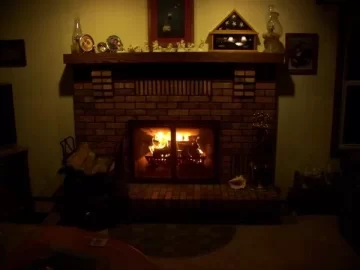

I was cleaning out my old 1975 Superior Heatform Fireplace today and noticed inside above the doors and lintel where the metal firebox meets the brick face was all rusted out and crumbling. I made a big hole about 1' long after banging out the rust. After further inspection I couldn't find any other deteriorating areas. This really sucks! We don't burn it often, but it's nice on those extra cold days and with the huge 6-7cu ft fire box it's nice to burn those oversized splits. I wonder if I could get away with patching it some how or just bite the bullet and look at either an insert or hearth stove? I did want to replace it eventually but not this soon, but I also don't want to do a half ash patch job and find out there is more deterioration somewhere else and end up burning the house down. I'm tempted to just rip the whole thing out and build a new hearth for a new Woodstock Keystone, but I think the wife likes the fireplace look. A Blaze King or Jotul Rockland would also look nice. Here's a pic of the fireplace in operation last year, couldn't take a pic of the damage yet. Dimensions are 35"w x 25"h x 23"d.

Yeah, that's a good idea. I know I could just cut out the loose rusty stuff. It's probably about 1-2" wide and 12-20" long. I might be able to fill the gap with furnace cement and stick a steel plate over it. But there is also some warpage in the plate above the heat tubes, maybe I can hammer it back. Money is pretty tight right now but with the tax credit it's awful tempting to throw an insert in there and get it done like I wanted to do eventually anyways.

It seems to be solid everywhere else on the inside that you can see but who knows about the outer shroud you can't see and there is also some warp on the top plate where the top brick supply vent is. This fireplace was built with the house back in 1975 by my Grandpa and I don't think there was ever a cap on top til I bought the place in 2003. I already repaired the cracked crown. Maybe I need a pro to come look at it and I'll buy him a beer or two? ;-)
