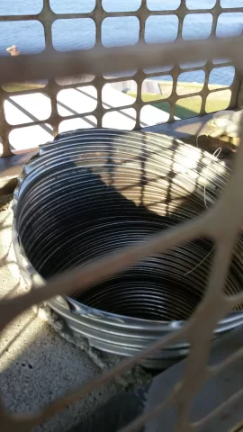

I picked it up for $2400. Liner is still at house i dont think im gonna use it, was cemented in up top and ovalized to fit down below. What kinda liner does it look like? Looks like it would collect alot of creosote.
[Hearth.com] new hamton hi300 insert on cl
That is a standard light wall flex liner. They don't really collect dirt to much But being ovalized and cemented in at the top it might not be worth the effort to pull it. If you are worried about it collecting dirt go with heavy wall flex liner it is smooth wall and a much better liner.

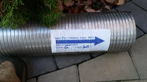

This a good liner? I helped a friend install this one for his hampton.
That is either heavy flex or mid weight which is the same construction as the heavy wall just with a little thinner material. Both are good liners.
